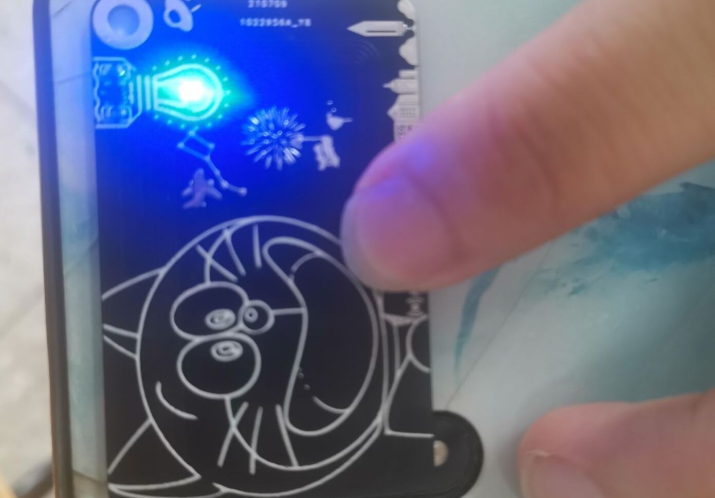

I am an electronics novice, and I made my own NFC card through the open source tutorial of the boss.
I plan to give it to my girlfriend, hehe
Directly above the picture:
When welding, I didn't notice that the chip was very small at first. I tried to solder it manually with a soldering iron tip, and then I realized something was wrong and I couldn't figure it out.
Later, I choose to blow directly with a hot air gun, apply tin in advance, and then apply solder paste and blow, blow, blow, OK.
I blew off the silk screen at first because I was really looking for the first pin of the chip. The person who looked for it was stupid.
When soldering, pay attention to the fact that the first pin of the chip must correspond to the schematic diagram, otherwise it will be useless to solder it.
Jialichuang used five boards for nothing (Jialichuang YYDS)
Then I bought five chips, and all five were successful. No chips were wasted. I was so happy.
Hahahahaha
As for the software, I directly searched the software online. Tagwrite NXP is the official APP.
Electronic novices can also create successful open source projects
