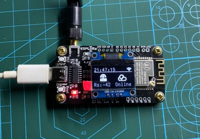

Project description:
This is a lorawan simple gateway based on ESP32S main control, plus a 0.96OOED display
Main control: ESP32-S LoRa module: Ra: RA-01 (SX1278)
ESP32SESP32S SX1278 LoRaRA-01(SX1278)
While studying, I discovered LoRa, another protocol related to the Internet of Things. I personally like to play with it. After a period of study, I will make a development board for it. I hope more people will play LoRa.
Note: This project is a single transmission gateway, which means that ESP_LoRa can be adjusted to receive mode or transmit mode according to needs (determined by the code).
It mainly uses Essence’s RA-01, which is a non-duplex module. Essence’s latest module that supports LoRa is the RA-07 series. Interested friends can study and learn.

Features:
1.Arduino language development, making it easier for novices to get started
2. Use three components, including a Zener diode, a 6V self-restoring fuse ( optional ), and ESD electrostatic protection ( optional ), to protect the circuit.
3. Use CH340C (disadvantage: large size) for serial port downloading, eliminating the need for crystal oscillator.
4. Adopt advanced Type-c interface (manual dog head).
5. Reserve a four-pin OLED screen for display. (Four pins 0.96, 1.3, etc. - pay attention to the pin order when making a board)
6. The module supports automatic burning, which is convenient and fast.
7. There are three types of LoRa module antennas to choose from (SMA, direct plug-in, IPEX4).
8. All available pins are lead out to facilitate secondary development.
9. The power supply adopts AMS1117-3.3. The measured voltage drop can be accepted at about 3.3V without affecting the use.
10. The M3 copper pillars are not suitable for fixing. I plan to paint a shell to beautify them.
11. Resistors and capacitors are all packaged in 0603, which is easier to weld than 0402, and 0805 takes up space (manual dog head again).
12. Reserve the test LED (D27) pin.

image display:
Front view
Front view
PCB front and back pictures
Startup interface diagram
Main program interface diagram
Program testing
