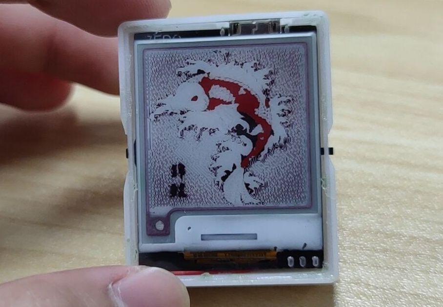

The original plan was to realize 100% of the functions of Zhihuijun's NFC card: simulate access control cards, NFC upload data, etc. It's a pity that I can't find good learning materials for NFC transmission data (anyone with relevant information is welcome to leave a message in the comment area and learn together, thank you!). The NFC function cannot be implemented. What can be done about this? How to upload image data?
After thinking about it for a while, I decided to make an ink screen card that is different from Zhihui Jun. I gave up the NFC solution and used a microcontroller virtual U disk. Put the pictures to be displayed into the U disk (FLASH). The microcontroller reads the bmp image data and Displayed on the ink screen.

Zhihui Jun chose a black and white two-color ink screen. I made a slight improvement here and changed it to a black, white and red three-color ink screen. The disadvantage is that it cannot be refreshed locally (fast) and can only be refreshed globally (very slow), but considering the screen size It is very small and only refreshes a few times a day. The slow refresh rate is acceptable.
So the question is, how to display a picture on a three-color screen? Since each "microcapsule" (each small pixel displayed) of the ink screen can only display one color: either black, red or white. So it is necessary for us to divide a picture into two colors. I have been studying this for a long time and tried many solutions:
Q : Doesn’t bmp store the values ​​​​of the three colors of BGR? The R value of red must be relatively large. For example, wouldn’t it be better to define R>200 as red?
A : Indeed, bmp storage is rgb, but the ink screen display is not rgb. To be precise, it is CMYK, similar to a printer. You can read this blog post for details. If you have not understood it before, it may be a bit confusing. If you think about it carefully, you will understand. Therefore, the R values ​​of pure red and pure white are both 255. According to your judgment, they are both "red" and there is a bug.
Q : Damn, let me give you an example. Just improve it, for example, R>200 && G<50 && B<50 (If you don’t understand this, you can think about it carefully). Wouldn’t that be great!
A : Some pictures can indeed be displayed, but when it comes to some more complex pictures, they are unsightly. Such a threshold cannot solve the red to white gradient picture, and it is obvious that the two sides of the dividing line are uneven.
Q :. . .
After several attempts, the effect is still not ideal, mainly because the constraints on red in the RGB color space are not clear. Finally, I decided to use the HSV color space to solve this problem (because HSV has a relatively clear distinction between red), and used RGB to HSV function:

In this way, we only need to put the image into the virtual USB disk and let the microcontroller automatically read, dither, and take the modulus. It is very nice and there is no need to worry about anything else.
Then there is the transplantation of FATFS. I won’t go into details on this. You can also refer to my last open source project: power meter power-X .
In this way, the whole process is very clear:
At this point, the project is completed~
The whole project is quite different from Zhihui Jun's, but the inspiration comes from him, thank you sir. Then abandoning NFC and using FASH storage also has advantages: it is simple to implement, and can store multiple pictures at the same time. A 4Mb flash can store hundreds of 152*152 bmp pictures.
