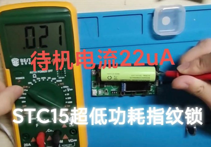

    采用18650电池供电,低功耗设计,安装简单,板载充电接口,设备待机电流22uA,一节锂电池可以使用3-6个月,实测从2021年7月8日正式装上,电池充满电(2000Mah,冲至4.2V),每天开门至少10次以上(寝室6个人),到2021年9月5日止,当前电压为3.86V,使用40%左右电量,实际测试,低功耗达到了要求。

  • The power supply voltage of the fingerprint module and OLED module is 3.3V. The device needs to be woken up by the touch of the fingerprint. Therefore, the touch sensor of the fingerprint needs to be powered all the time, so a low quiescent current linear voltage regulator is needed to reduce power consumption;
  • The overall standby power consumption is measured to be about 22uA, which is mainly the quiescent current of the fingerprint touch sensor and linear LDO. The power-down mode of the STC15 microcontroller can control the current below 0.1uA;
