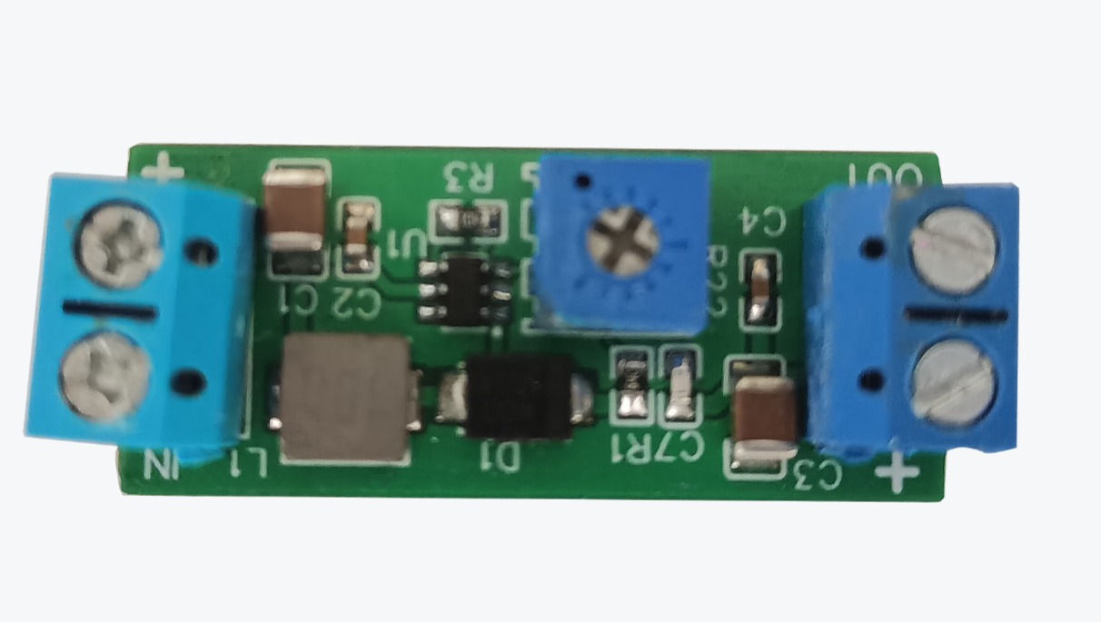

5. How to use
This solution is very simple to use,
1. Input 2V DC ~ 24V DC at the input end (the PCB is marked with "IN")
2. Adjust the For the voltage adjustment potentiometer, the voltage becomes smaller when rotated clockwise, and the voltage becomes larger when rotated counterclockwise (when adjusting the voltage, please use relevant measurement tools, such as a multimeter to determine the output voltage)
3. If "OUT" is marked on the PCB, the corresponding voltage will be output
. Details See the reference design download for usage pictures.
