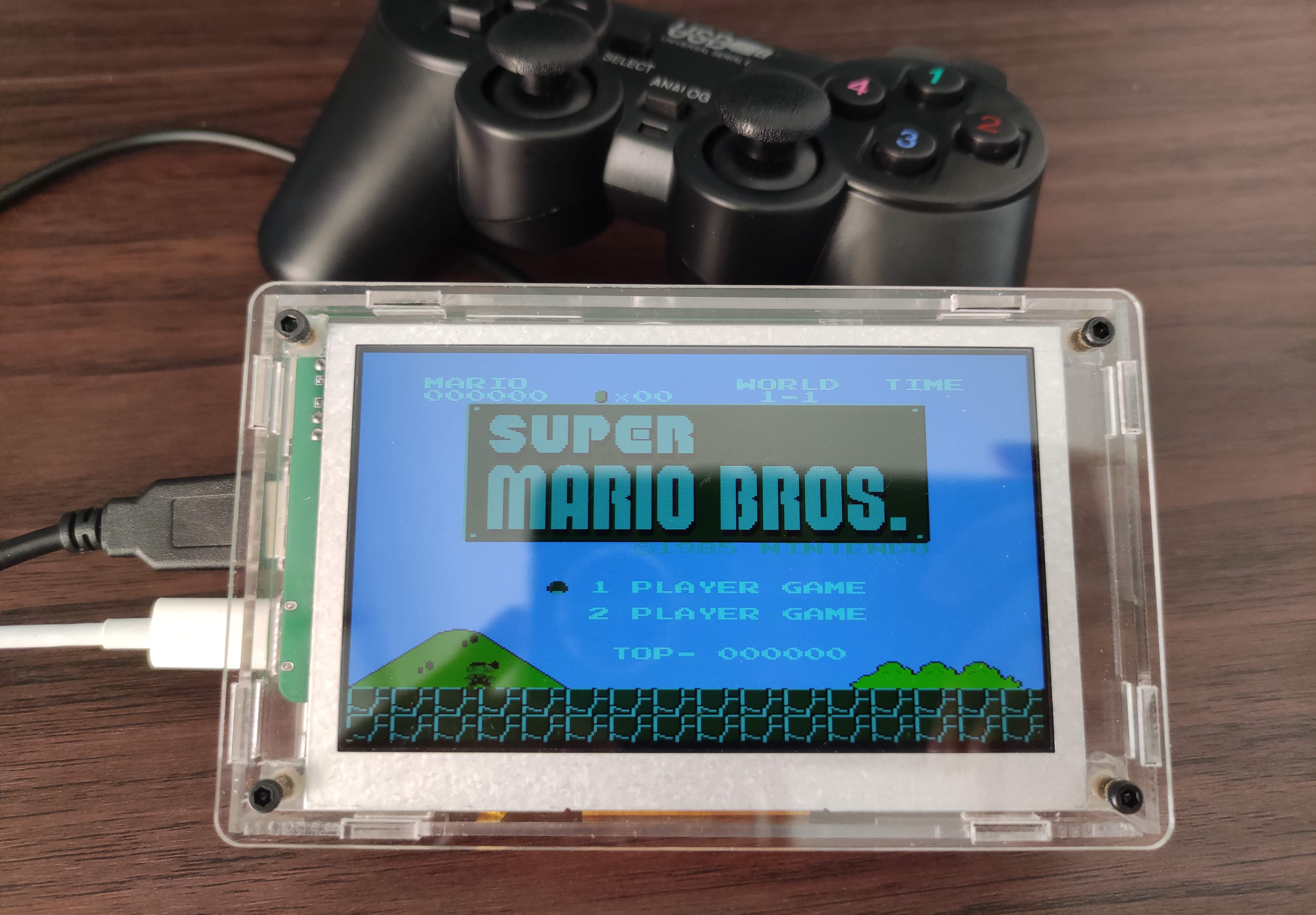

The main control adopts Allwinner V3S, single-core Cortex-A7, 64MB memory
board with rj45 network port, headset, microphone, TF card slot, USB, 40pin RGB screen interface
4.3-inch 800x480 resolution screen
casing is acrylic (see design drawing Shell, the DXF file can be exported and can be customized and cut in a certain treasure), M2.5 screw fixing
demonstration video
https://www.bilibili.com/video/BV19r4y1M7cf
physical picture
