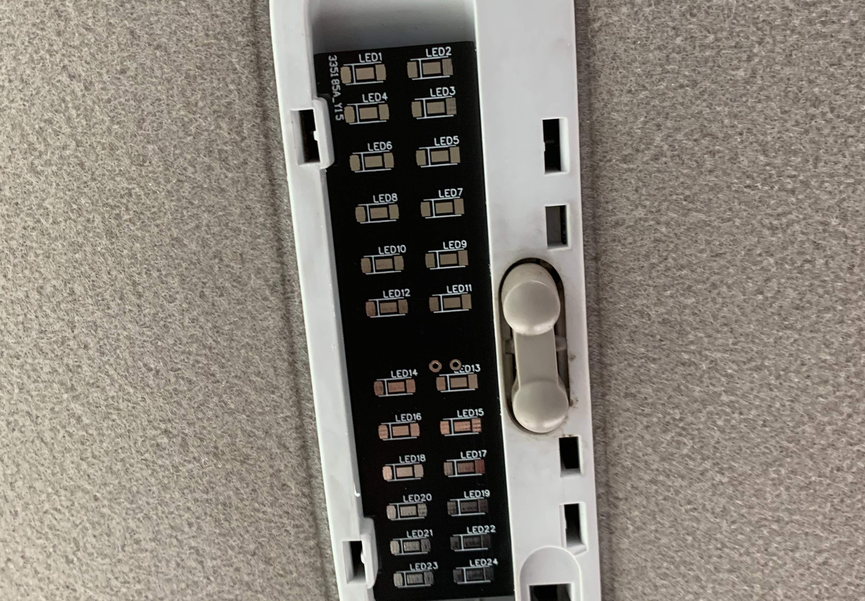

To replace the original T10 halogen lamp, only the design of the LED lamp board is given here, and the T10 bulb plug engineering reference ( https://oshwhub.com/ACTG/t10-deng-pao-zuo )
Use MPS's MP24895 as constant current control, and use R2512 alloy sampling resistor to implement current sampling and control the current size.
