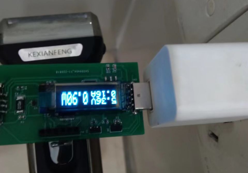

* 1. Project function introduction:
Slightly modified the USB power meter of Open Source Plaza, added a crystal oscillator, and enlarged the PCB, which is more friendly to novice soldering, Jiali Chuang Summer Training Camp 2022
* 2. Project attributes:
* 3. Open source agreement
GPL3.0 ,
please fill in during the competition stage↓
* 4. The hardware part
is designed according to the training camp routine (5V);
the PCB size is increased, which is more friendly to novice soldering and easier to solder;
a passive crystal oscillator is added;
a 0.91-inch OLED screen is installed on the board to make the entire USB power meter smaller (the actual three-dimensional measurement is about: 67mm*20mm*10mm);
the sampling chip INA199B1DCKR is changed to INA199A1DCKR;
