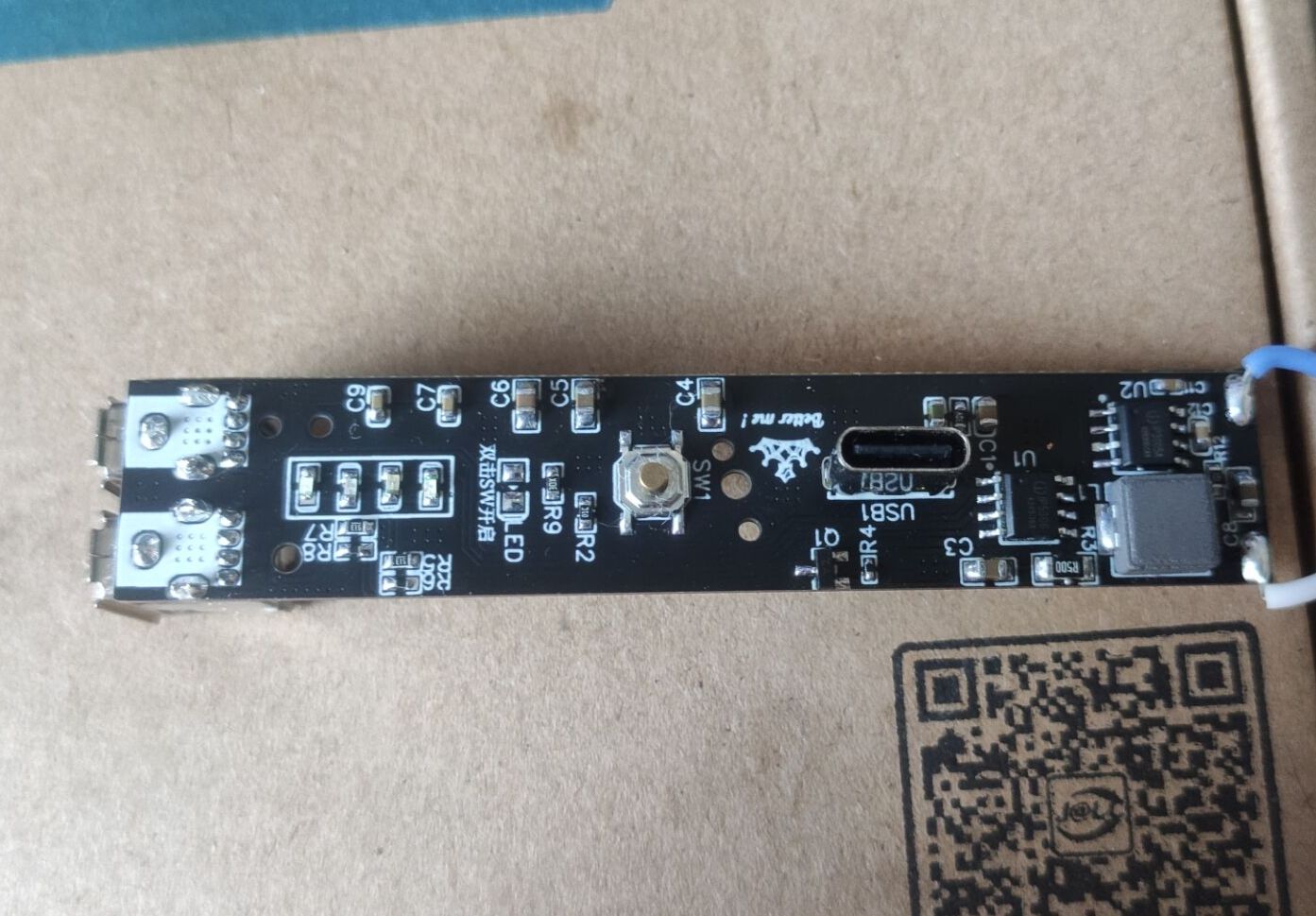

Romans 10000mA power bank replacement motherboard ip5306
·The motherboard hole position is the same as the previous hole position. For Type-C charging, the charging hole needs to be polished.
·Charging management chip IP5306, 5V2A,
·Battery protection chip IP5300A,
·The battery protection chip DW06D I used before will automatically power off when charging two mobile phones with one chip. To solve the problem, connect two chips in parallel. According to the chip manual, I changed it to IP5300A.
·The actual measured current reaches 1.46A.
·Please tell me the problem. Schematic diagram
