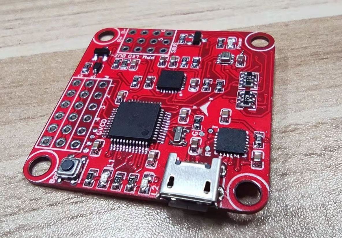

NAZE32 flight control V1
NAZE32 flight control V2
Personally, I recommend the V2 version . Compared with the V1 version, V2 has improved:
1. The MicroUSB interface is replaced by a Type-C interface; 2.
BAT54C rectifier is used between USB power supply (about 5.2V) and external 5V power supply;
3. ESC The interface is replaced from 3*6P pin header to 1*8P pad;
4. Add 1*4P pad for communication serial port and its SH1.0 socket;
5. Add FLASH on the board for black box function.
1.Welding instructions
The BMP280 barometer part, CP2104 serial communication part, and SPI FLASH part are all optional parts .
If a certain function is not used, this part of the circuit does not need to be soldered to reduce costs and manufacturing difficulty.
1.1 NAZE32 V1 description
The BMP280 barometer part and the CP2104 serial communication part are shown in the figure below. This version of the PCB does not add the SPI FLASH part.
The BMP280 barometer is used to measure the altitude information of the drone and achieve functions such as height determination. The flight control can be used normally without this part.
The CP2104 serial communication part is used for serial communication between the flight control and the ground station (computer-side configuration software) and firmware burning. If you have a USB-TTL downloader, you can not solder this part of the circuit and connect the three GRT pads with flying wires to the USB-TTL downloader:
G->GND
R->TXD
T->RXD
5->5V
For convenience, it is recommended to solder the CP2104 serial communication circuit.
1.2 NAZE32 V2 instructions
The BMP280 barometer part, CP2104 serial communication part, and SPI FLASH part are shown in the figure below.
The CP2104 serial communication part is used for serial communication between the flight control and the ground station (computer-side configuration software) and firmware burning. If you have a USB-TTL downloader, you can not solder this part of the circuit and connect the G-5-RT cable interface to the USB-TTL downloader using an SH1.0 cable:
G->GND
R->TXD
T->RXD
5->5V
The SPI FLASH part is used for the black box function of the flight control to store flight data. The flight control can be used normally without this part.
