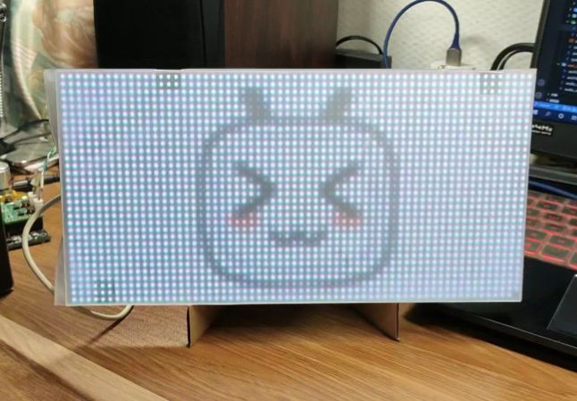

LED full color dot matrix screen driver board
Full color LED dot matrix screen
Introduction
A simple full-color LED dot matrix screen program with clock, temperature, music spectrum, bad apple, full-color animation, text display and other functions

Due to the epidemic, the LED diffuser I bought did not arrive, so I used an ordinary transparent plastic plate and a frosted plastic bag to make a temporary diffuser.
If the diameter of the LED is relatively large, buy a thicker diffuser. The specific effect needs to be adjusted by yourself.
