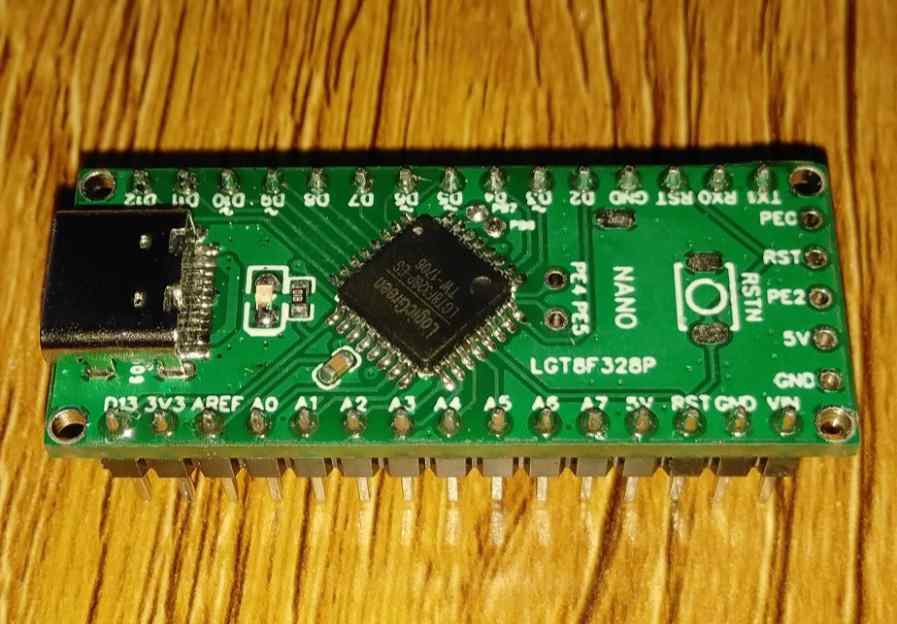

![3.jpg] ![2.jpg] ![a.gif] Domestic LGT8F328P chip, compatible with Atmega328p chip. The pin size sequence is compatible with Arduino NANO. It adopts TypeC interface and the USB to serial port uses CH340K chip. The use of cylindrical crystal facilitates manual welding. Export all GPIOs. Lead to the SWD simulation interface. Can be used as AVR core board. Because the NANO and UNO chips are the same, the BootLoader is also the same. For usage methods, please refer to [Larduino UNO Domestic Chip Compatible Board] (https://oshwhub.com/costar/larduino) Notes: Masking tape can be used to handle the plug-in before soldering the SMD components. The solder pads are stuck tightly to avoid the trouble of plugging holes due to hand slipping.
