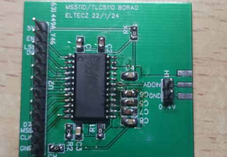

【Verified】MS5510 ADC verification board
According to the board made by Ruimeng MS5510, it should be able to be used on the original TI chip. This board uses mode one and supports input of 0-2V.
Parameter: VADC=0-2V
           VDC=4.5-5.5V
           VDOUT=4.5-5.5V
           FMAX=20M
It is recommended to cooperate with FPGA. Of course, you can also connect to 32 FMC. I am too lazy to bother here.
I have to say that this chip is really cheap. You can get a 20M ADC for five yuan. It is made in China (although it is copied (
Attached is a picture of the actual object
(The welding is the same as $
