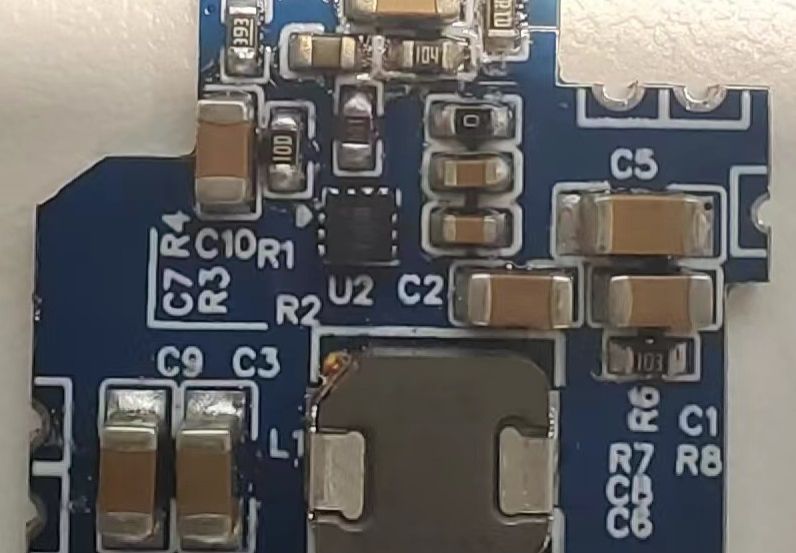

SY7065/66 verification board
Due to structural and demand constraints, this special-shaped boost module is prototyped, with dimensions of 1.87*2.92CM, input voltage: 1.8-5V, output voltage: 5V, output current: 2A. The actual board can be enlarged without stamp holes.
Note: The temperature rise of the module output above 2A is too large and heat dissipation is required.
The module has been verified and some measurement parameters are as follows:
  • No-load ripple testNo-load ripple
  • 1A load voltage test1A power supply1A voltage
  • 1A ripple test1A ripple
  • 1A temperature test1A temperature
  • 2A load voltage test2A voltage2A load
  • 2A ripple test2A ripple
  • 2A temperature2A temperature
  • 3A load voltage test3A voltage
  • 3A temperature3A temperature
