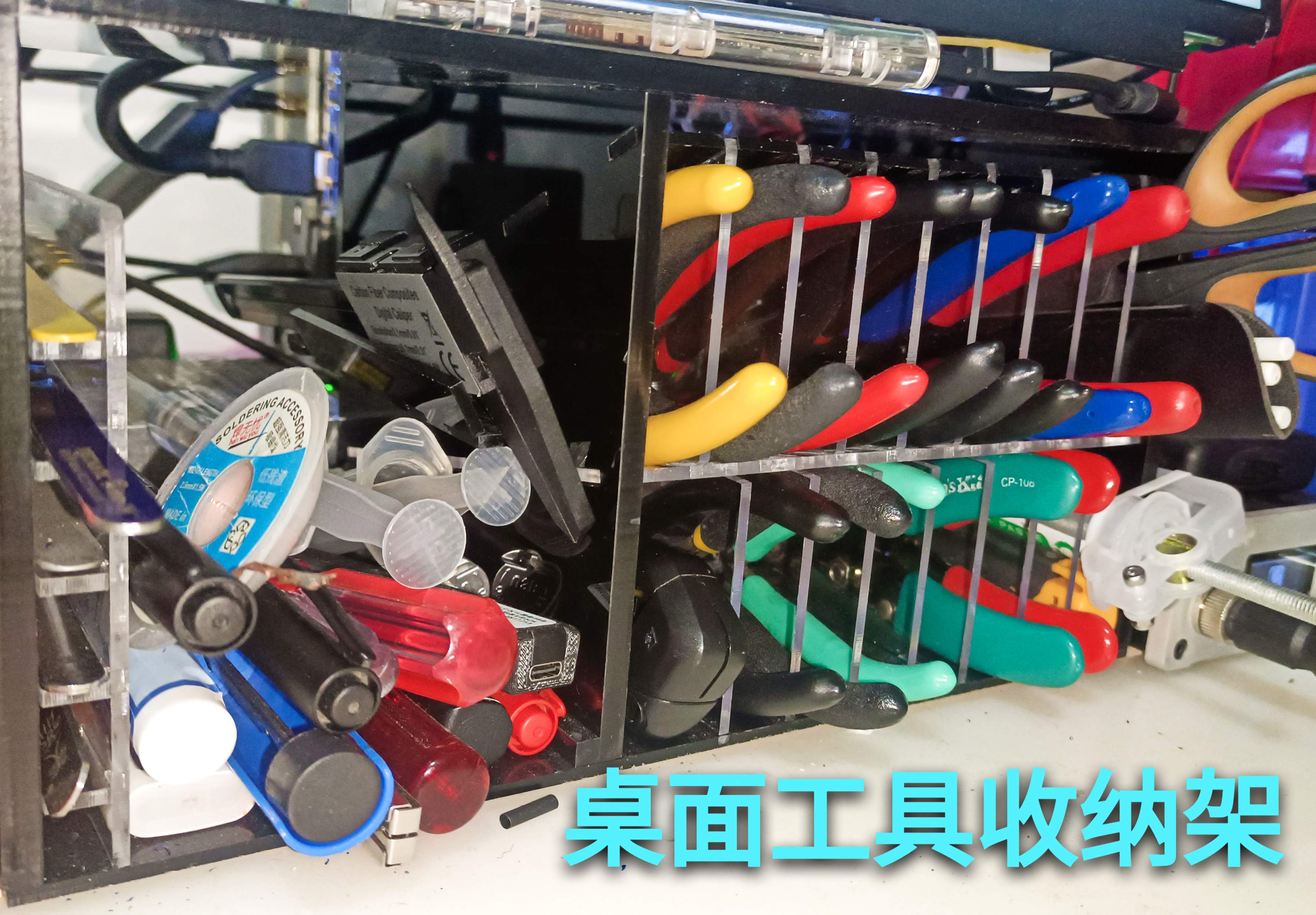

Of course, I started using this storage rack after moving and it has been used for almost two months.
Here is a picture of the actual shelf, the pliers part is basically full.
So why did it take so long to update?
The main reason is that although this shelf has met my original design goal, it is not good enough!
As you can see from this picture, the stack of tools on the left is quite messy, and the scissors and solder extruder on the far right cannot be stored well, so I have been thinking about how to revise it, maybe making a 3D one. The printed bracket is matched (opening a new pit), hoping to allow more tools to "return to their positions"
But because I have been too busy recently, the subsequent updates have not been completed, so I have been mumbling for a long time and have not been embarrassed to update (
I hope that all the big guys can also contribute their own ideas for improvement, thank you!

Here are some pictures of the finished product: (Because I didn’t bring all the tools back, I will show you a rough usage effect first, and I will add photos later)
The small balcony in the bottom picture is for the vernier caliper.
I’ll add others as I think of them, and I’ll update them when I get all the tools.
