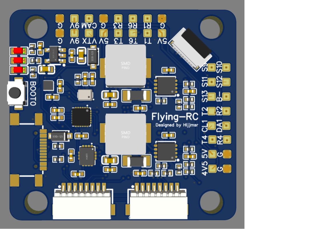

chipset:
mcu:stm32h743vit6
imu1:bmi160
imu2:mpu6500
compass:bmm150
baro:spl06-001
osd:at7456e
becs:5v2a,9v2a,3.3v ldo max300ma
Note:1.able to link to additional sensor(IMU,BARO)board through fpc cable, ideal maximum imu number : 7!!!
2.able to link to additional bec board for servos, a maxium number of 15
3.no can bus output / chip supported
4,all cap/res are in 0402 size, a hot wind blower may be necessary for assembling
