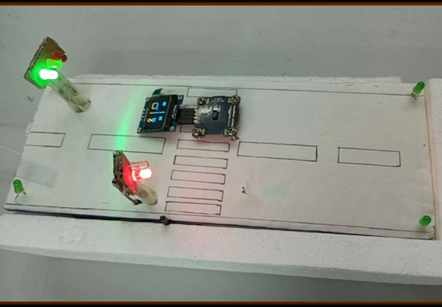

11. Scene construction
At the teacher's request, we built a very crude road model, which was made of discarded foam and foam board... The ESP32 board is hidden under the board. As shown in the picture below,
