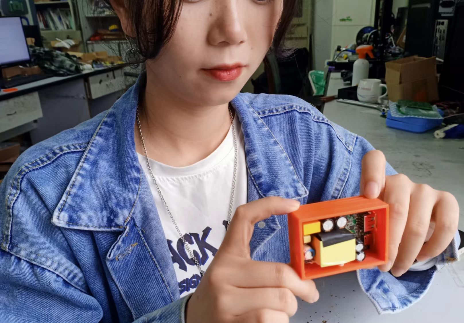

65W super gallium nitride power charger
The picture above is Xiaoqing, a programmer in the laboratory. Here are a few more photos. Bilibili video link: https://www.bilibili.com/video/BV1wr4y187bM#reply111765361936
