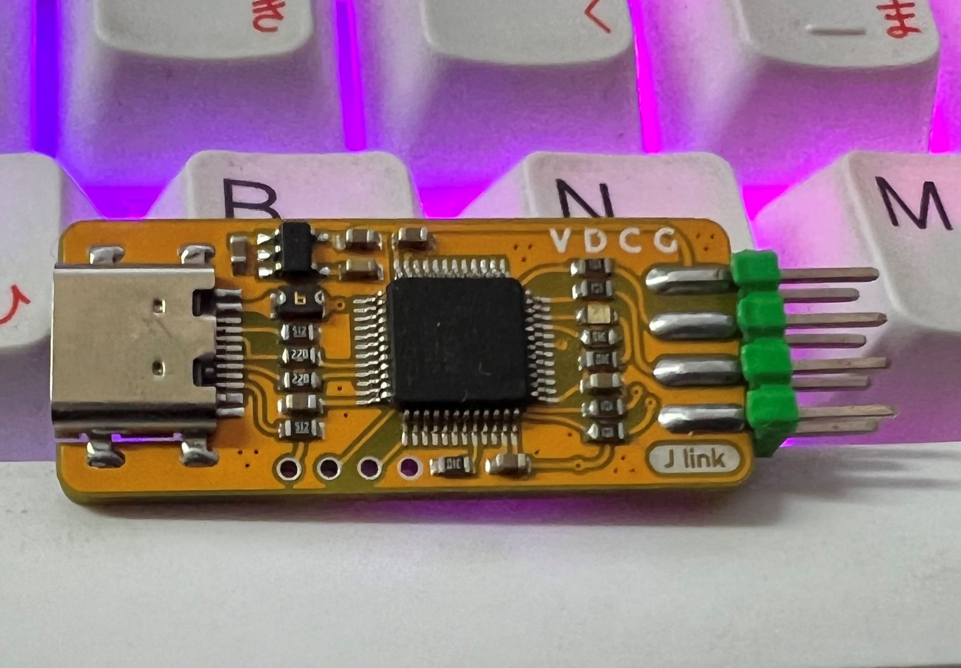

JLink-OB is a JLink_OB download emulator based on STM32F072C8T6. It has the same functions as J-Link and ST-Link, and supports virtual serial ports for easy debugging. Onboard 5V and 3.3V output, suitable for various Cotex-M core microcontrollers.
This version uses the latest USB Type C interface, the internal crystal oscillator of the microcontroller, eliminating the need for an external crystal oscillator, and the PCB area is smaller.
PCB size 33X15
When using RT9193 for LDO, NC welding of 10-22nf capacitors is fine. When using XC6219B332MR, do not weld it when it is left floating.
After the welding is completed, the program can be directly burned and used, no other operations are required! ! !
