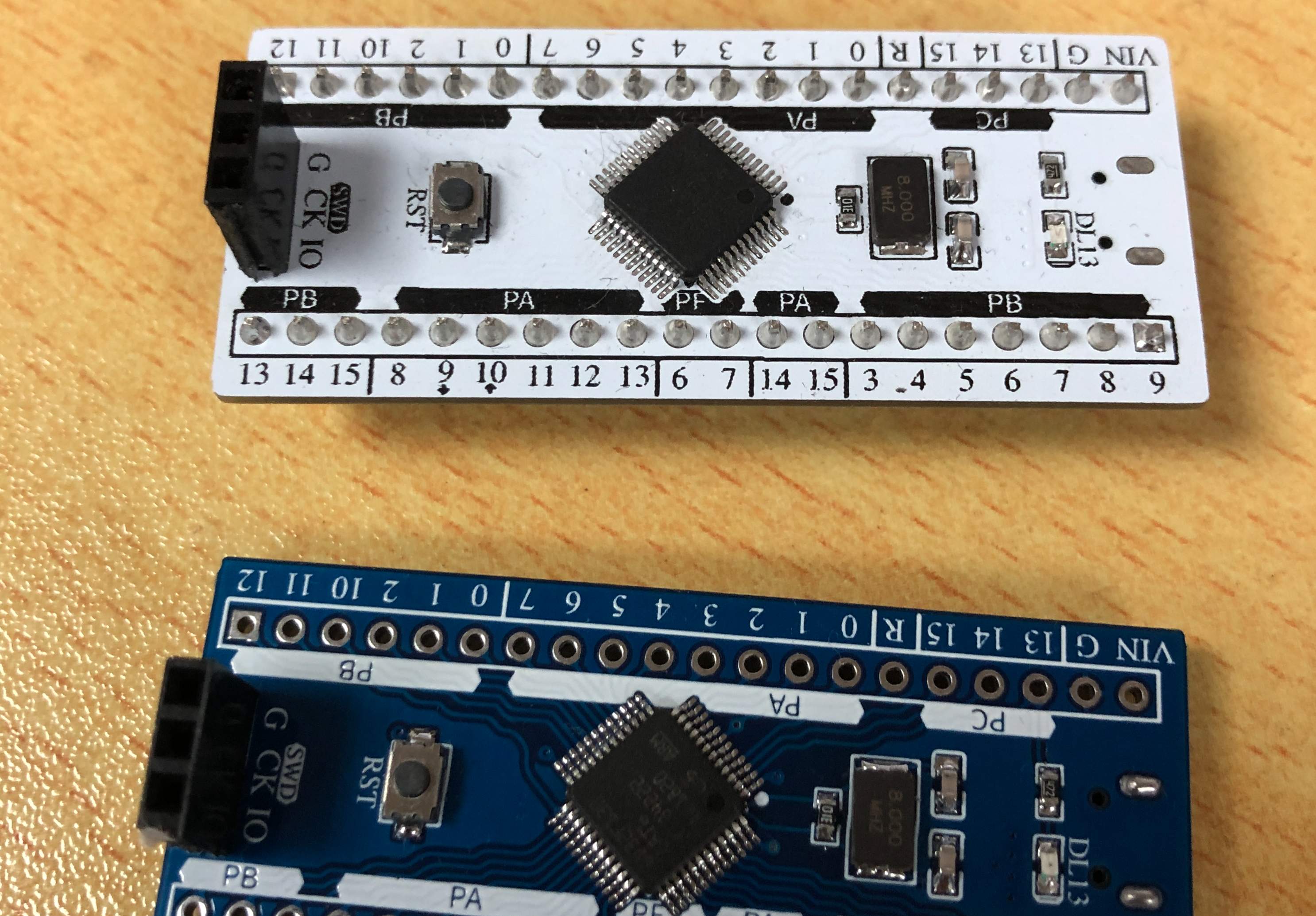

gd32f130c8t6 minimal system board
Introduction to GD32F130C8T6 microcontroller
Package: LQFP48
Core: Cortex-M3
Family and positioning: GD32 Value Line (super value model, focusing on cost performance, benchmarking STM32F030)
Working voltage: 2.6~3.6V
Flash ROM: 64KB (the first 32KB has the best performance, zero wait for access, and the code should not exceed 32KB)
SRAM: 8KB
Maximum system clock speed: Can run 72M, no problem at all
Working environment: -40 ~ +85℃
SysTick: 1
Watchdog (WDT): 2
RTC: 1
EXTI:16 Line
GPIO: 39
DMA: 1 (7 channels)
ADC: 1 ADC unit (1unit, 12bit resolution, 10 channels)
USART: 2 (USART0, USART1)
I2C: 2 (I2C0, I2C1)
SPI: 2 (SPI0, SPI1)
General timer (GPTM): 1 32-bit (TIM1), and 5 16-bit (TIM2, TIM13~TIM16)
Advanced timer (Advance Timer): 1 16-bit (TIM0)
Basic Timer: None
USB: None
DAC: None
Design Notes
Power supply: Use RT9193-3.3 as the LDO chip, the maximum input voltage is 5.5V, the typical value is 5V. 5V power can be input through the McrioUSB female socket or pin header.
Download and debug: Use the SWD interface to download and debug. It is recommended to use the CMSIS-DAP emulator. In order to improve the stability of the SWD interface, it is recommended to pull up SWDIO with a 10K resistor and pull down SWDCLK with a 10K resistor .
