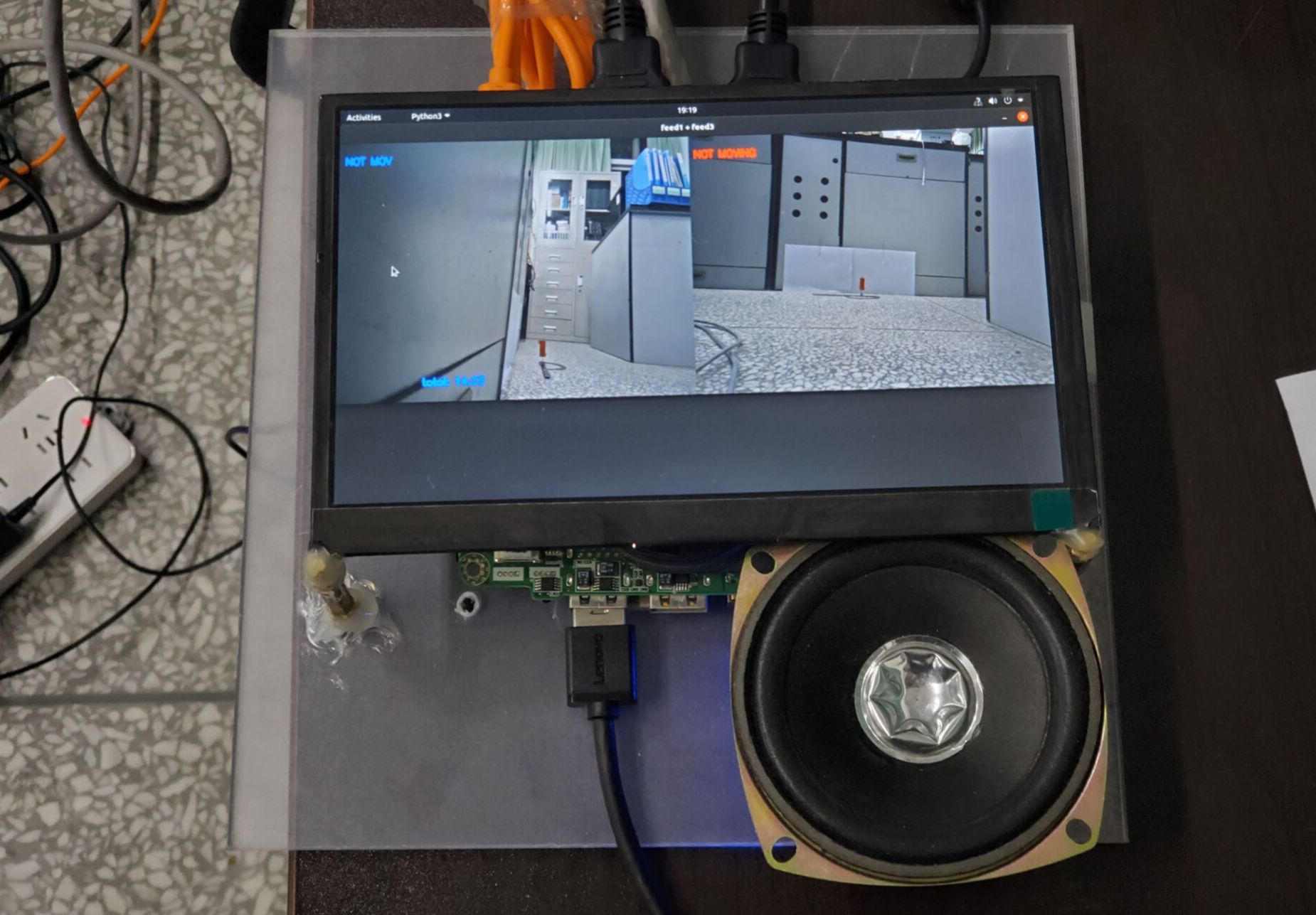

Physical demonstration of the terminal, displaying real-time images of two nodes at the same time, and using speakers for voice prompts.
