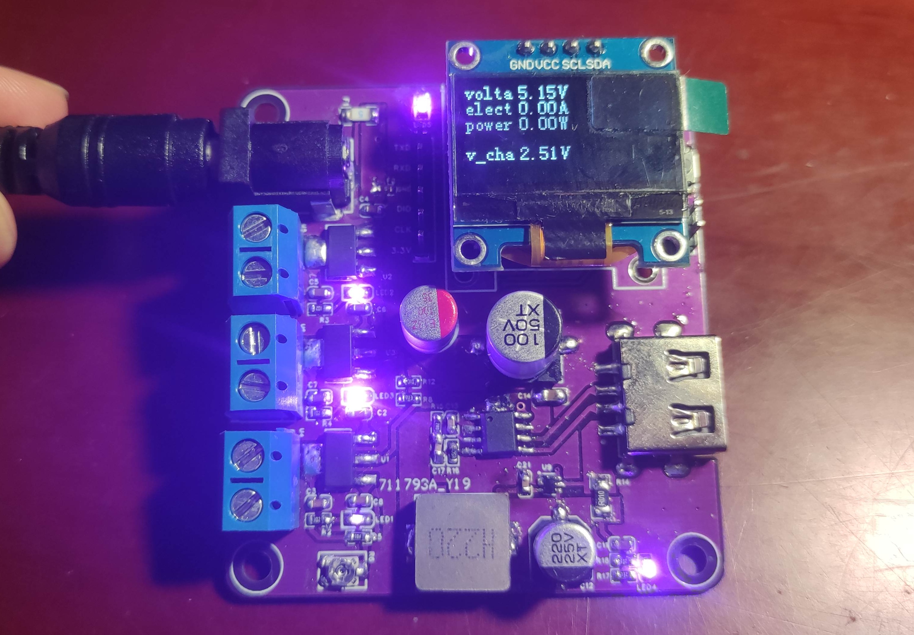

       (1) Ability to display information such as voltage, current and power
      . This function uses the chip N32G430C8L7 as the main control. The N32G430C8L7 microcontroller product uses a high-performance 32-bit ARM Cortex™-M4F core, integrates a floating-point unit (FPU) and digital signal processing (DSP), and supports parallel computing instructions. The maximum operating frequency is 128MHz, and it integrates up to 64KB of on-chip encrypted storage Flash, supports multi-user partition authority management, and supports 16KB of embedded SRAM. It has an internal high-speed AHB bus, two low-speed peripheral clock buses APB and bus matrix, supports 40 reusable I/Os, provides rich high-performance analog interfaces, including 1 12-bit 4.7Msps ADC, supports 16 external input channels and 3 internal channels, and provides a variety of digital communication interfaces, including 4 U(S)ARTs, 2 I2Cs, 2 SPI/I2Ss, and 1 CAN 2.0B communication interface. The N32G430C8L7 microcontroller product can work stably in the temperature range of -40°C to +105°C, with a supply voltage of 2.4V to 3.6V, and provides a variety of power consumption modes.
      The figure below is the core circuit of the N32G430C8L7. When designing the circuit, it should be noted that each power pin must be connected to a 100nF capacitor for filtering. And the 1 pin needs to be connected to an additional 4.7uF capacitor. At the same time, in this design, an LED is connected to PB0, which can be used as a light to verify whether the circuit chip is available.
       The voltage and current information is collected through the ADC pin of N32G430C8L7, and the power information is obtained by N32G430C8L7 through calculation. The display is realized by a 0.96-inch screen, which communicates with the main control N32G430C8L7 through I2C, so that the power supply, current and power information are displayed on the screen. The figure below is the screen connection circuit.

       The development software used in this project is keil. In the schematic diagram of this project, the SWD debug pin and USART1 pin of the main control are brought out for debugging and downloading the program. I use the SWD pin and the debugger is ST_LINK V2.
       The following figure is a program flow chart.
       From the flow chart, we can see that the program first enables the system clock and the clocks of all peripherals used, then initializes the log (the log will send error information through the serial port when the program reports an error, which is a function in the official routine), followed by the initialization of I2C, which should be placed before the initialization of OLED to ensure that OLED can communicate with the main control, and finally the initialization of peripherals, including OLED, DMA, ADC and LED.
       Then enter the while loop, in the main function, first convert the data collected by ADC into actual voltage value, current value and power value according to the formula, and then display these values ​​on the OLED, and finally flip the LED to make it flash to prove that the program is running, and then enter the while loop again to achieve real-time refresh on the OLED.
