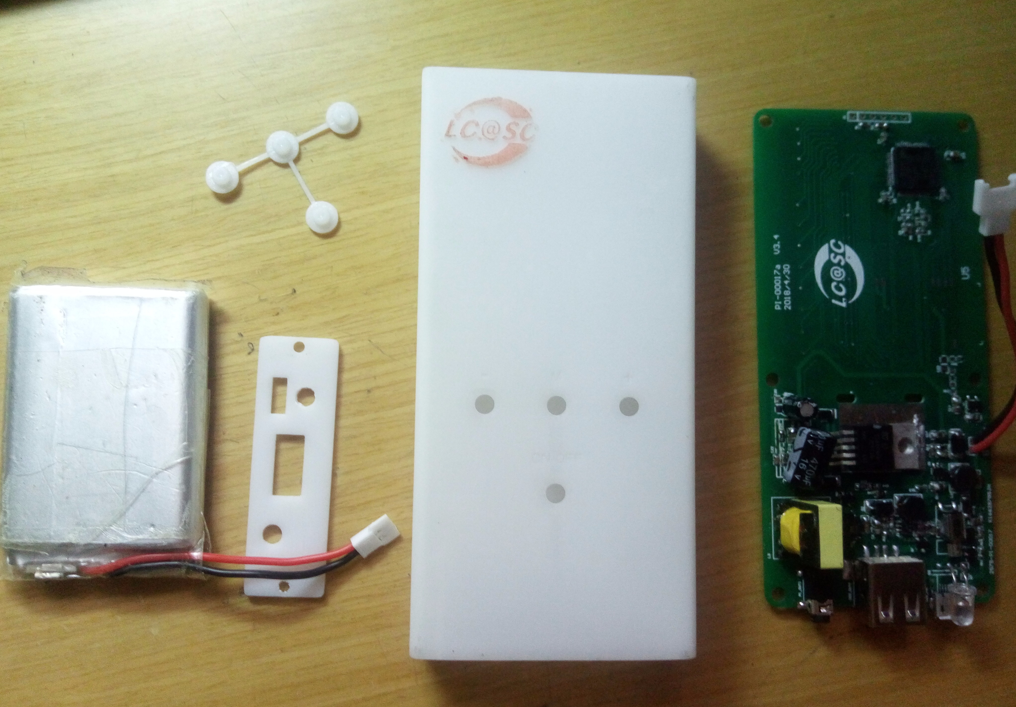

* 5. Upload pictures of your work; (The PCB must have the competition logo and take a photo and upload it. If not, it will be deemed as giving up the competition)
1. Soldered circuit boards and accessories from 3D proofing
