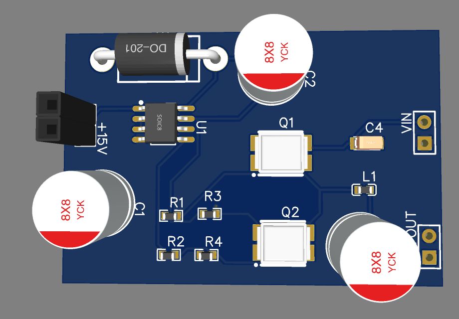

Made by Lichuang eda-bidirectional DCDC automatic voltage stabilizing system with 9v output

Engineering Explanation:
                Based on the above analysis, the purpose of this circuit is to automatically reduce the voltage of 9v-50v (up to 600v, 50v is only limited by the withstand voltage of the electrolytic capacitor) to 9v for output. It is realized by outputting PWM wave from the microcontroller. For example, input 18v, output 9v, the duty cycle of the PWM wave is 50%; input 12v, output 9v, the duty cycle of the PWM wave is 75%, and so on. Then the output logic setting of the pwm wave is relatively simple and can be achieved using a simple pid algorithm (see mian.c of the engineering code file).
Physical demonstration:
                See the video attachment (voltmeter on the left), it can be seen that the input voltage is between 13v and 24v When changing between them, the output can be stable at around 9v.
