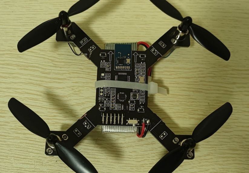

Main control: GD32F103CBT6 (GD32F103C8T6, STM32F103C8T6, WCHF103C8T6 are all compatible)
Receiver: Nrf24l01 (recommended by Yibit, more stable)
Motor: coreless cup 8523 motor (Lihua Electronics 5.5, set of four)
Propeller:75mm
Power supply: 1s battery, 600mAh~1000mAh recommended (maximum 1800mAh).
Interface: Support ST_link programming and debugging, reserve serial port to communicate with anonymous host computer, reserve optical flow serial port
(Note: When making boards, choose 1.6mm)
Source code address: https://gitee.com/gitee_Fei/perfei_-fly
Remote control project address: https://oshwhub.com/jiaLC_fei/remote
Note: If there is a problem with the LiChuang project, you can download the PCB source file from the attachment and import it into the project.
