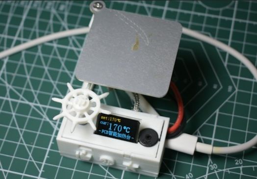

Compared with the first version, the second version has higher cost, and the corresponding functions are more complete, including temperature control and display screen. Buzzers, etc.,
the heating plate uses an aluminum substrate, and the wire pattern is a Hilbert curve, which can perfectly fill the entire plane.

also conducted a simple test
1. Temperature control, which is basically stable and reliable, and was compared with an infrared thermometer.
2. Raise the heating table to 180 degrees and heat for more than 20 minutes. The structure will not deform due to heat.
3. The actual welding operation was also carried out, and the effect was good.

Question: This version of 78M05 feels a bit overheated (the board can be used normally). I will replace it with the next version. If you have a small size step-down chip, you are welcome to recommend it.
