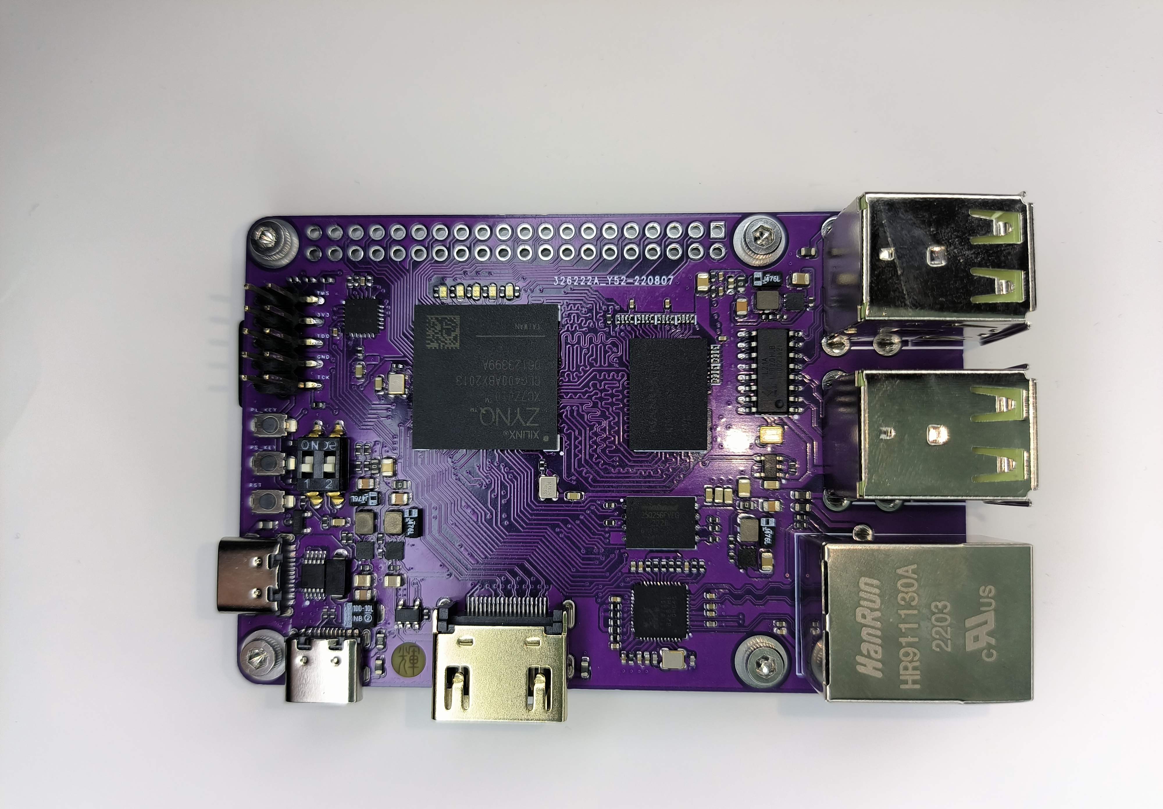

Introduction: A development board based on the ZYNQ7010, with the same size and interface as the Raspberry Pi
1. Why this board was made
In order to treat my own mental insufficiency, I made a ZYNQ7010 board to occupy all my free time to force myself not to think randomly all day long.
I also want to make ZYNQ boards cheaper so that everyone can afford them. There are tens of millions of mansions in Ande, which can shelter all the poor people in the world with joy!
2. Functions of the board
The board has the same interfaces as the Raspberry Pi, four USB2.0, one Gigabit Ethernet, one HDMI, one power interface, one debugging serial port, one burning port, and one SD card interface. A set of GPIOs. 3. The super detailed instructional video on
how to make this board has been posted on Station B. Search for BV19G4y1r7i5 on Station B. 4. The production process is to prepare tools for disassembling the chip , flattening the high-temperature tin cover, steel mesh, brushing solder paste, melting the tin into a ball , patch heating table, welding wind Weld the reverse side with a gun, solder the plug-in with an electric soldering iron, and assemble it on the touch screen. Flash the SD card into the system and start the system. Connect the HDMI to the large screen and connect to the Internet cable. Open station B.
