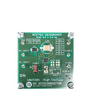

NCP781BMN033TAGEVB: NCP781 3.3V high-voltage linear regulator with enable function demonstration board
NCP781BMN033TAGEVB: NCP781 3.3V Very High Voltage Tolerant Linear Regulator with Enable Function Demoboard
The demoboard supports the very high−voltage tolerant linear regulator NCP781 in DFN6 3.3 x 3.3 package with fixed output voltage 3.3 V. The ENABLE function allows turn the device to low consumption mode with quiescent current about 1 uA. The device is able to withstand continuous DC or transient input voltages up to 150 V. The small output capacitor 0.1 uF is sufficient for stable behavior and allows smaller PCB design at space constraining applications.
Size: 50mm x 50mm x 19mm
Features and Applications
Wide Input Voltage Range: 6 V to 150 V
Output Voltage Versions:
Fixed 3.3 V
±2.5% Accuracy at Room Temperature
Very Low Quiescent Current of Typ. 25 uA
Standby Current: 1 uA
Stable with a 0.1 uF Ceramic Output Capacitor
Very High PSRR: 83/56 dB@1/100 kHz
Thermal Shutdown and Current Limit Protection
Available in Thermally Enhanced DFN6 3.3 x 3.3, 0.65P Package
Ideal for Harsh Environments
These are Pb−free Devices
Telecom, Industrial
Bias Power Supplies, Led Lighting
