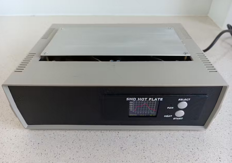

Open Source SMD Reflow Soldering
500W 200mm x 100mm hot plate with designed housing. The problem with heating surface mount devices (SMDs) is that if they are heated or cooled too quickly, damage can occur to the device. Additionally, the flux in the solder takes time to activate, and any water vapor that may have penetrated needs time to evaporate. This typically involves soaking at 150 degrees Celsius for about 90 seconds and then increasing the temperature to about 220 degrees Celsius to melt the solder paste. Therefore, the manufacturers of these components provide thermal curves, which you can sometimes obtain from their respective datasheets.
