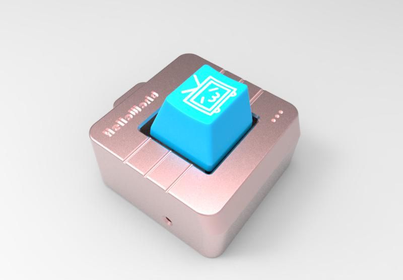

Recently I have been paying attention to Mr. Zhihui Jun’s Hanwen keyboard, and then I accidentally saw it when I was checking the axis body. When I saw the axle tester, I thought it was quite interesting, so I came up with the idea of ​​making one.
Just a while ago, I reproduced @liujigang's Iron Man NFC card. I was thinking about combining the axis tester with the NFC card. I could also use NFC to power the axis and control the LED light to turn on and off. No need to It is powered by batteries, so as long as you have a mobile phone with NFC function, you can play happily.
So I tried to make such a hot-swappable test shaft with NFC function. I used CATIA to draw a small shell. The style of the shell was drawn in the style of Zhihui Jun Hanwen's keyboard. The drawing was not good. Please don’t criticize me!
The upper cover and lower cover are fixed with three M2*5 cross countersunk head screws. The lower cover needs to be pre-pressed with three M2*4-3.5 knurled nuts in the three holes.
The video link of the finished product is attached below. Everyone is watching, thank you!
Finished video
https://www.bilibili.com/video/BV13d4y1k7qq/?share_source=copy_web&vd_source=6e8478cee4a1f23547235f65080e79f9
