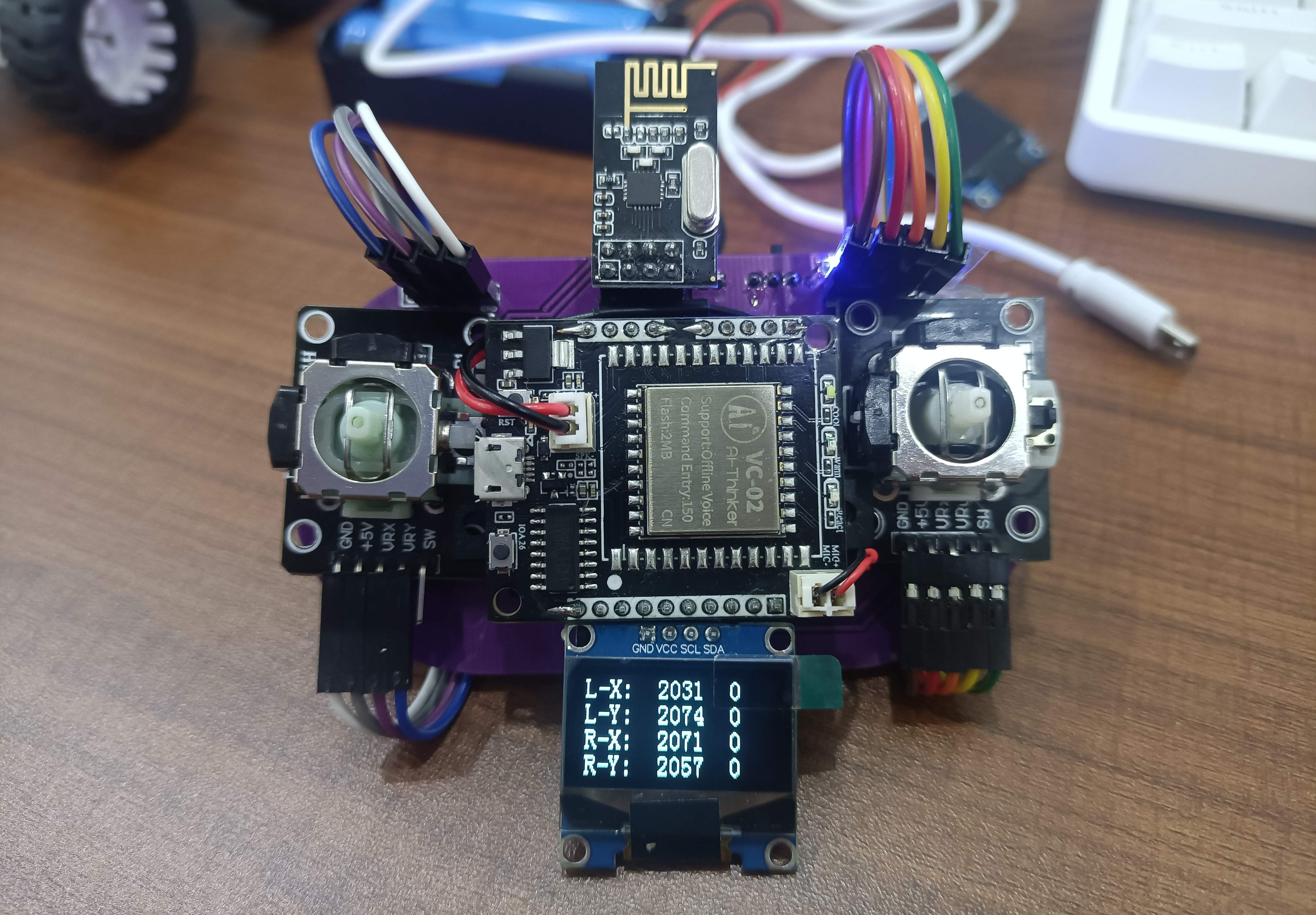

![33BEA0F905161A20A1108B1C261293BD.jpg] This project mainly uses the Anxinke VC-02 voice module to realize voice recognition. By sending preset commands to the microcontroller, the car can be controlled by voice.
Most of the cars and remote controls use the pin header direct plug-in method. The microcontroller uses the STM32F103C8T6 minimum system board. The offline voice module and the microcontroller can be directly connected through serial port communication to realize data transmission. You can also draw another remote control board and establish communication through 2.4G to achieve long-distance remote control. The first version of the car uses the offline voice module and the microcontroller directly through the serial port communication, and the second version uses the 2.4G radio frequency module communication to realize remote control. The circuit design
is simple, and some existing problems will be gradually improved.
