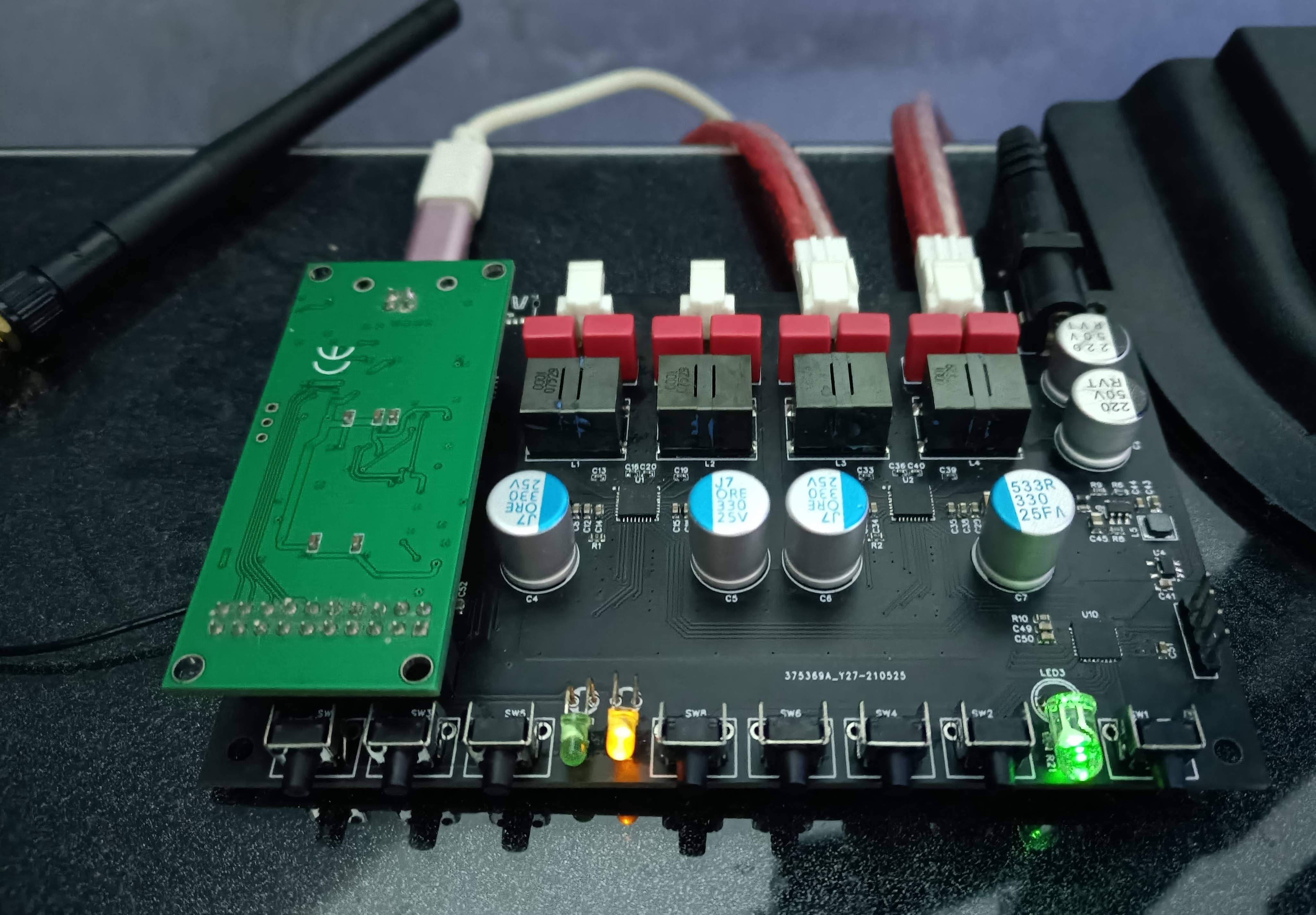

Description:
TAS5825M is a 38W stereo, 65W mono, 4.5V to 26V, digital input Class D smart audio amplifier with 192kHz architecture. With Amanero digital interface and QCC5125 module, it can realize high-definition USB and Bluetooth LDAC audio input, thus meeting desktop HiFi needs.
System architecture:
The amplifier is composed of five parts: 1. TAS5825M digital audio amplifier; 2. STM32F051 controller; 3. QCC5125 Bluetooth audio module; 4. Amanero digital interface; 5. USB PD power supply module (not used). The circuit uses a two-layer PCB (the four-layer PCB was still 5cmx5cm free at the time, and the professional version was not easy to use).
        uses Texas Instruments' TAS5825M digital amplifier chip as the main amplifier. The chip uses I2S digital output and has a switching frequency of up to 768kHz, which can simplify filter design and retain high-frequency audio signals to meet the basic requirements of Hi-Res. Because the chip integrates digital-to-analog conversion and Class D amplifier, there is no need for additional decoding chips and amplifier chips, achieving true monolithic integration, greatly reducing PCB area and simplifying circuit design.
        TAS5825M needs to be configured using I2C and cannot run alone. It supports multiple ways of playing, such as changing the volume. There is no POP sound when it is powered on, and there is no background noise when it is silent. There are no problems in other analog Class D amplifiers.
        This amplifier configures TAS5825M as BTL output, and has two independent amplifiers, that is, 4-way output, designed to separate treble and bass (later it was found that there would be a large background noise when two amplifiers worked at the same time, so the other channel was not used)
2. The STM32F051 controller
        MCU is responsible for the power on and off of the amplifier, the USB/Bluetooth switching of the audio signal, the configuration of the amplifier and the volume adjustment, and is equipped with an automatic shutdown function. When there is no audio signal input for a long time, the amplifier is automatically shut down to reduce power consumption.
        The Bluetooth module is responsible for receiving Bluetooth audio signals. The version that supports LDAC is used to meet the requirements of high-definition audio.
        The digital interface is responsible for USB audio stream input.
        The switching between USB audio stream and Bluetooth audio stream is controlled by MCU SN74LVC244 for switching.
5. USB PD power supply module (unused)
        is designed with Type C PD power supply, but there is no PD charger, so I simply didn't solder it. The chip was not easy to buy at that time. I used the CH244K PD deception chip, which supports PD 20V input at most.
User experience:
        It is used with a 4-inch full-range speaker, which basically reaches the level of HiFi products on the market. Because it uses USB input, you don't have to worry about the problem of high noise when the volume is turned up, and you don't have to worry about other interference. Even if you don't turn it off at night, it will turn off automatically. If you don't turn on the computer occasionally, you can turn on Bluetooth to connect your phone to play music.
        The two-layer board is not very good, but now the four-layer can't use mixed colors (sad).
        Only one of the two-way amplifier is used, which is a bit wasteful.
        There is no shell, so it is easy to accumulate dust. But I can't make a shell myself. If there is an expert who makes a shell, you can cooperate with me to make a new model.
