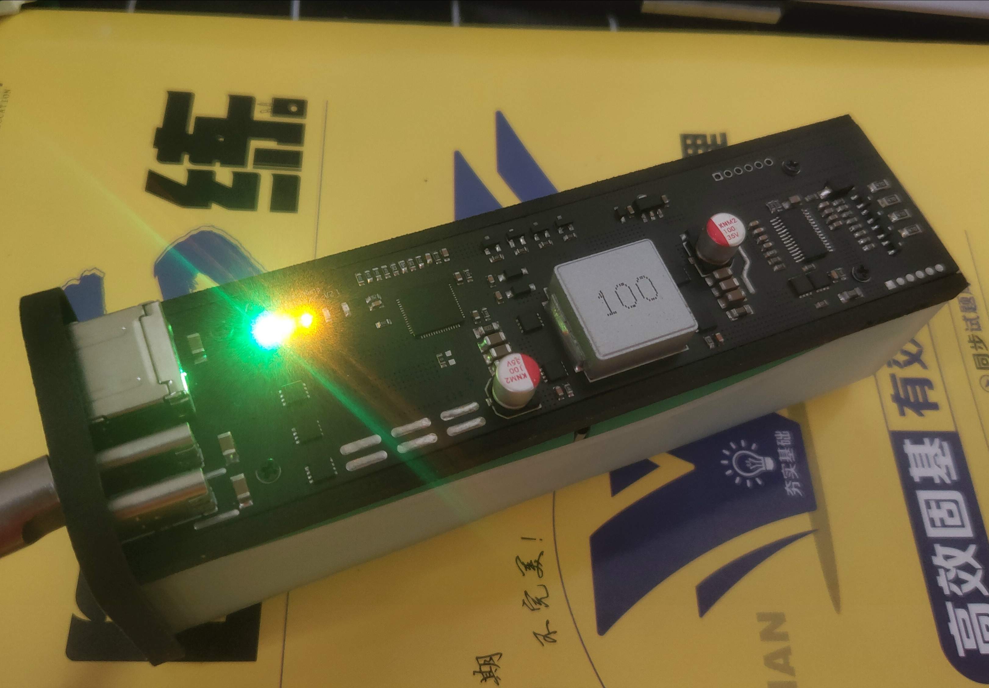

IP5389+BM3451 power bank
Purpose of production:
1. I bought a transparent power bank from PDD, and found that the capacity is not only small, but also generates a lot of heat, and half of the components are on the back of the motherboard and cannot be seen on the surface, so...
2. Lichuangfa Color Printing White Whoring coupons, you know
some of the component links:
USB-A female socket all-inclusive https://m.tb.cn/h.50Pn39n?tk=IN6rdGi6TDK
TYPE-C 14Pin female socket side plug https://m.tb. cn/h.50PnXgP?tk=F8iWdGi6RO6
RU3030M2 https://m.tb.cn/h.5b4HNaj?tk=zN2ldGi76Yt
IP5389-BZ-AACC https://m.tb.cn/h.50PKbMd?tk=AZT2dGi7wB1All
in one Molded inductor 1770 https://m.tb.cn/h.5YuUrA9?tk=HOcBdGi8gG7
Hardware description:
1. Due to the rapid popularity of TYPE-C interface, many fast charging tend to be TYPE-C interface, so the ACC interface is used Design
2. Use a large 1770 inductor to increase the current load capacity and enhance heat dissipation
. 3. Since I am relatively primitive, I think LED lights look better than digital tubes, so...
4. All components are designed on the front to facilitate personal welding.
5. The design follows the principle of good-looking, and I try my best to lay it out as much as I can (some places are not carefully laid out, welcome to debug)
6. I drew the casing by myself. I am a beginner at SU, so I can’t draw enough details.
