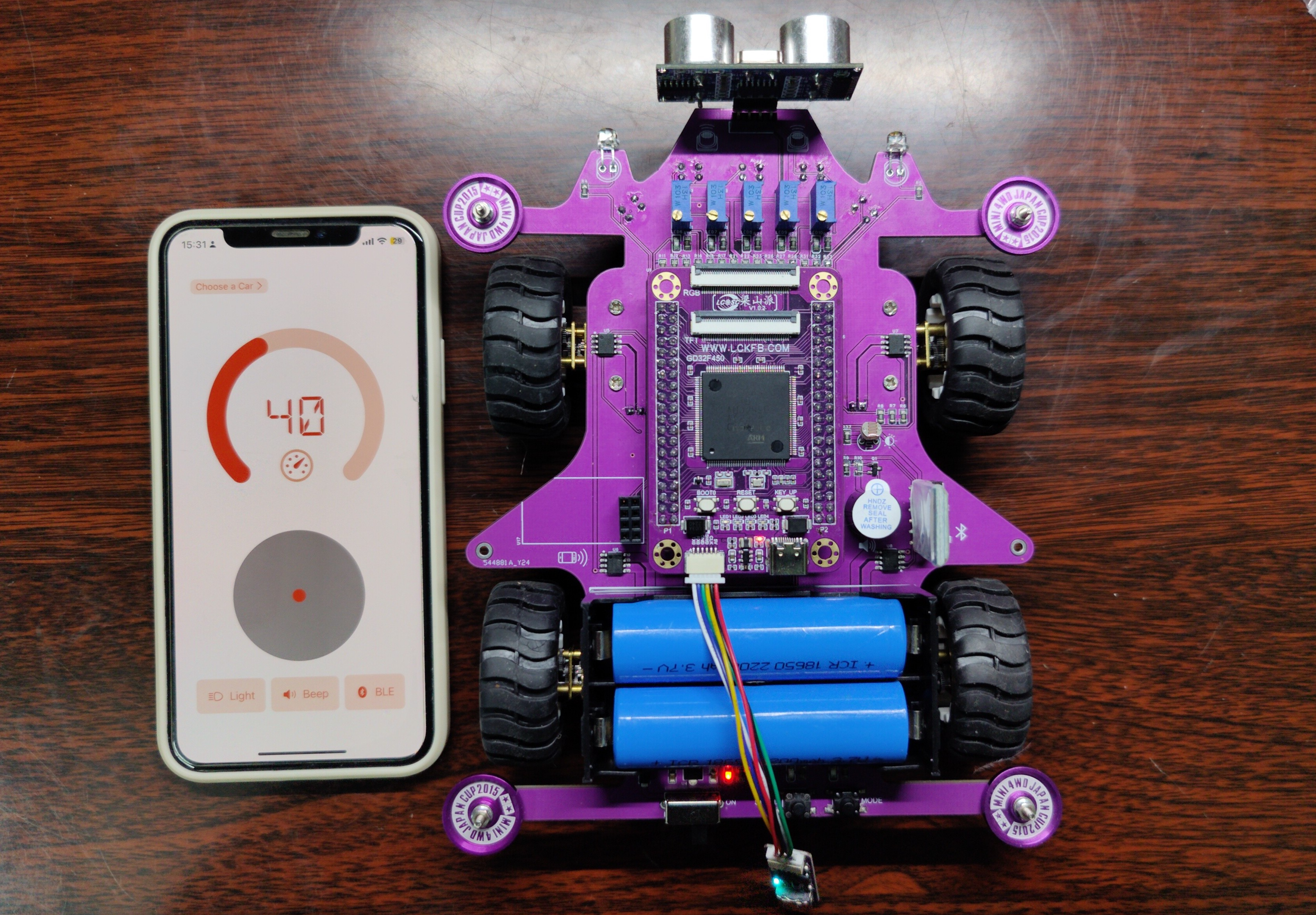

This project comes from the winter vacation training camp. Based on the Lichuang Liangshanpai development board GD32F470ZGT6, a four-wheel drive smart car was completed.
Through this project, you can learn to master the professional version of Jiali Chuang EDA for circuit design, PCB drawing layout, Jiali Chuang's one-click order, Lichuang shopping mall component procurement, and also learn a wealth of knowledge such as single-chip microcomputer development, electronic circuit design, and Liangshanpai's communication with other electronic modules.
## Function Introduction
This project mainly implements the following functions:
1. Four motors are driven and speed-regulated independently;
2. Infrared tracking;
3. Ultrasonic obstacle avoidance;
4. ADC: power detection and ambient light brightness detection;
5. Mobile phone Bluetooth BLE remote control;
6. Buzzer prompt;
7. Button start and switch mode

The two pictures above show that the BI pin of the upper left motor driver chip is connected to the PB4 pin of the development board GPIO through LQ-.
![image.png]
Combined with the user manual of the development board, it is known that PB5 of the development board is in pull-up mode during power-on or reset, and the PA7 pin connected to LQ+ is low, so the left front wheel will turn during this period.
**Solution: Replace other pins or set PB5 to low level after initializing the motor. **

![image.png]
