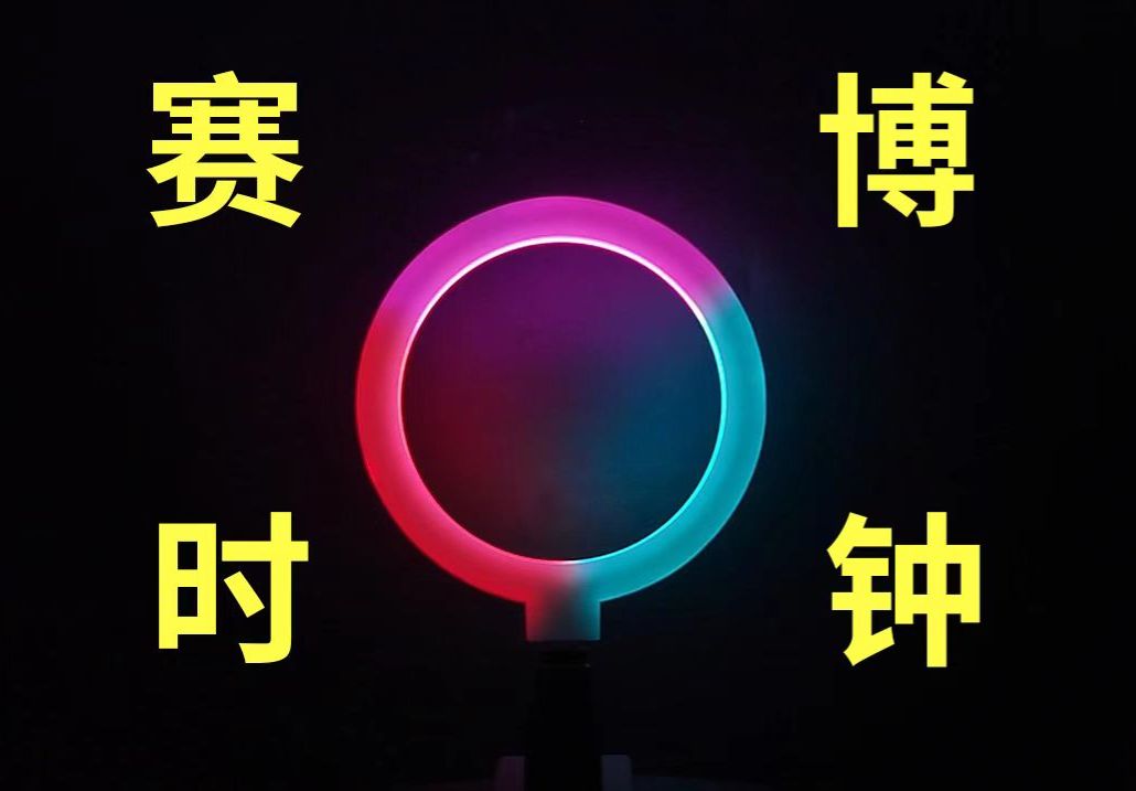

### **I. Product Introduction**
This is a multifunctional cyberpunk ring. You can use it as a desktop ornament to display cool cyber animations; you can also use it as a cyber clock to display time; you can also use it as an expansion module of the computer to display the CPU, memory and other occupancy rates. In short, as long as the mind does not slip, there are always more solutions than problems. As long as you dare to think, he can do it. For
more details, please see the demonstration video:
[[Self-made] Cool Cyber ​​Clock! A clock cooler than the floating clock is here! The strongest cyber ring in history! ](https://www.bilibili.com/video/BV1NX4y1B764/?vd_source=ca2c3c1fc46ea99bc22948cf76a9770b)
[Cool Cyber ​​Clock Tutorial! Friends who want to copy click here! ! ! ](https://www.bilibili.com/video/BV1Gs4y197su/?vd_source=ca2c3c1fc46ea99bc22948cf76a9770b)
