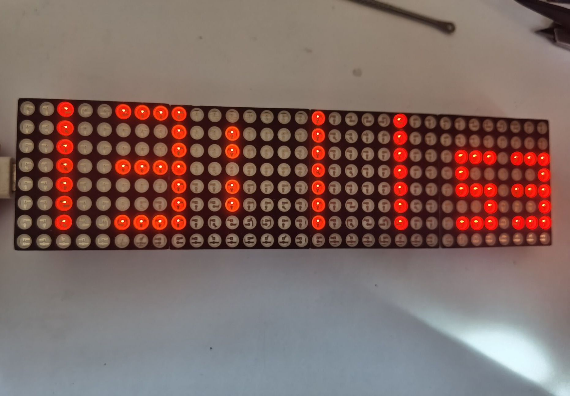

Matrix clock based on ESP12 and 1158AB
The matrix clock based on ESP12 borrows the layout of the hack laboratory. The hardware is designed with two buttons, DS1302 and DHT11 temperature and humidity sensor.
At present, the function only realizes network distribution and network display, borrowing Xiaokai's webpage network configuration.
The burning part can be soldered to CH330N, or you can use USB to TTL according to the pin header and use the button near the Type-c port to pull down io0, or use the ESP01 dedicated downloader to automatically pull down and burn.
For the 5V to 3.3V conversion part, if you don’t want to buy capacitors and AMS-1117-3.3V, you can directly buy the AMS1117 module. The pin header interface compatible with the module is reserved.
Pay attention! BOM order is not available. Please match the BOM according to the silk screen, description, and actual pictures.
