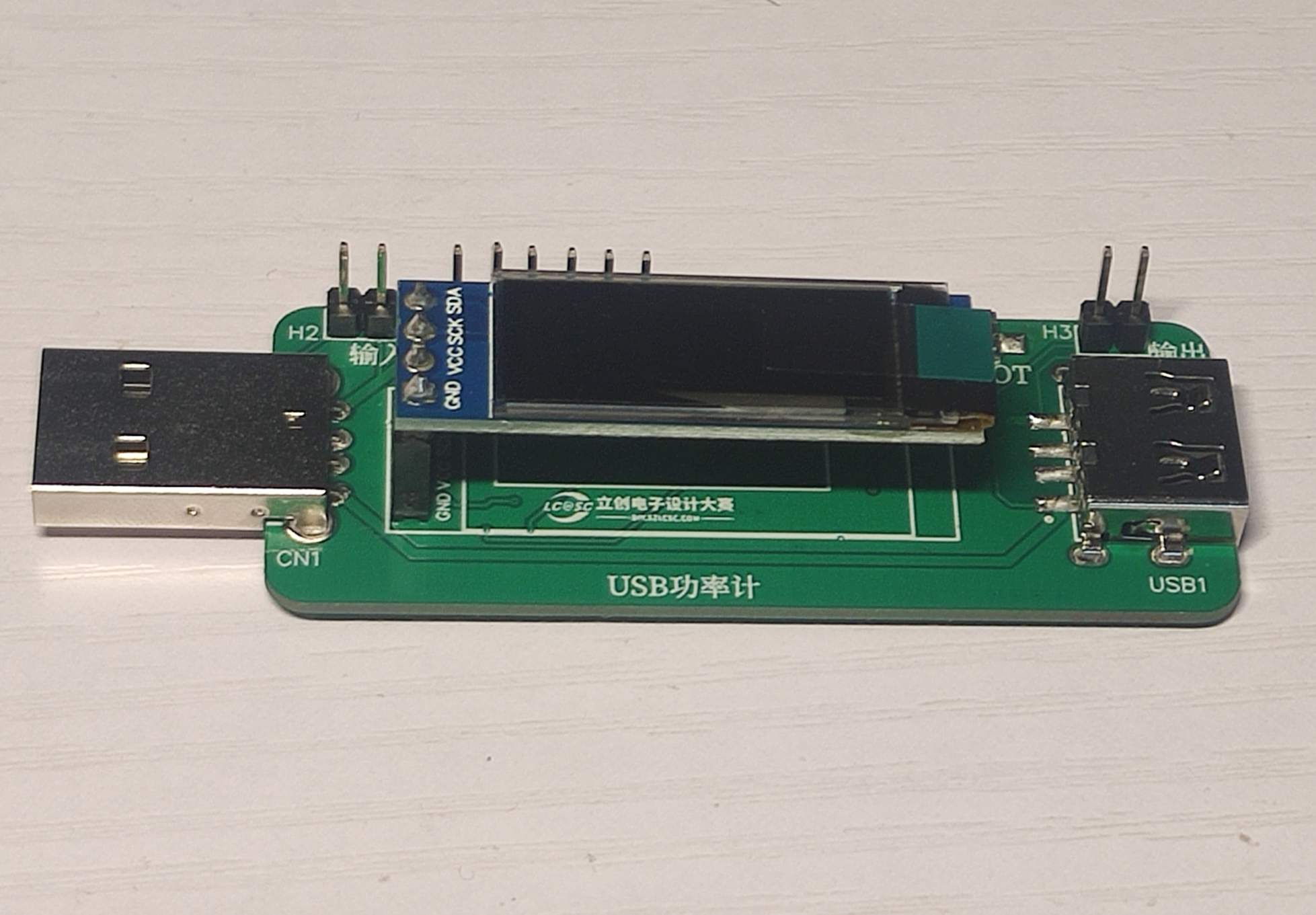

* 1. Introduction to project functions
: A USB ammeter based on N32G430C8L7+INA199 with an accuracy of 1%. It can check the current when the USB is working. This project is a 5V voltage power meter that does not support fast charging display.
*2. The project attributes
are public, and some official designs are used for reference and self-made
* 3. Open source agreement
GPL3.0
*4. The hardware part
uses the National Technology N32G430C8L7 model microcontroller, the Texas Instruments INA199 chip for current sampling, and the Torex XC6220 linear regulator to power the circuit.
*5. The software part
is developed using Keil5, and the code refers to the official case.
