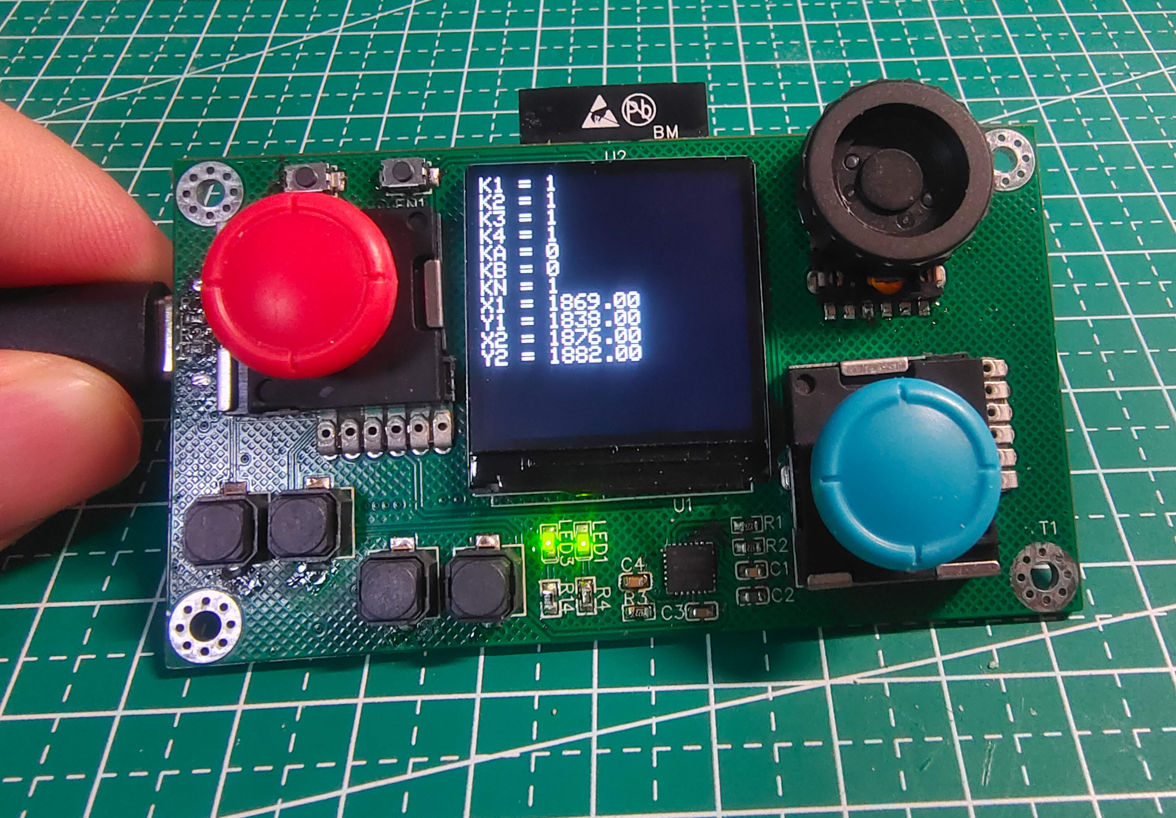

Mini_Telecontroller
A compact remote control controlled by esp32-wroom-32. It has two fake domestic switch rockers with buttons, 4 membrane silent micro buttons, a Panasonic EVQWKL001 wheel encoder with button function, and An MPU6050 gyroscope chip can be used for somatosensory control; currently there is only the control part, and there is a power board base plate, which is connected to the control board through copper pillars for power supply, forming a complete DIY remote control;
