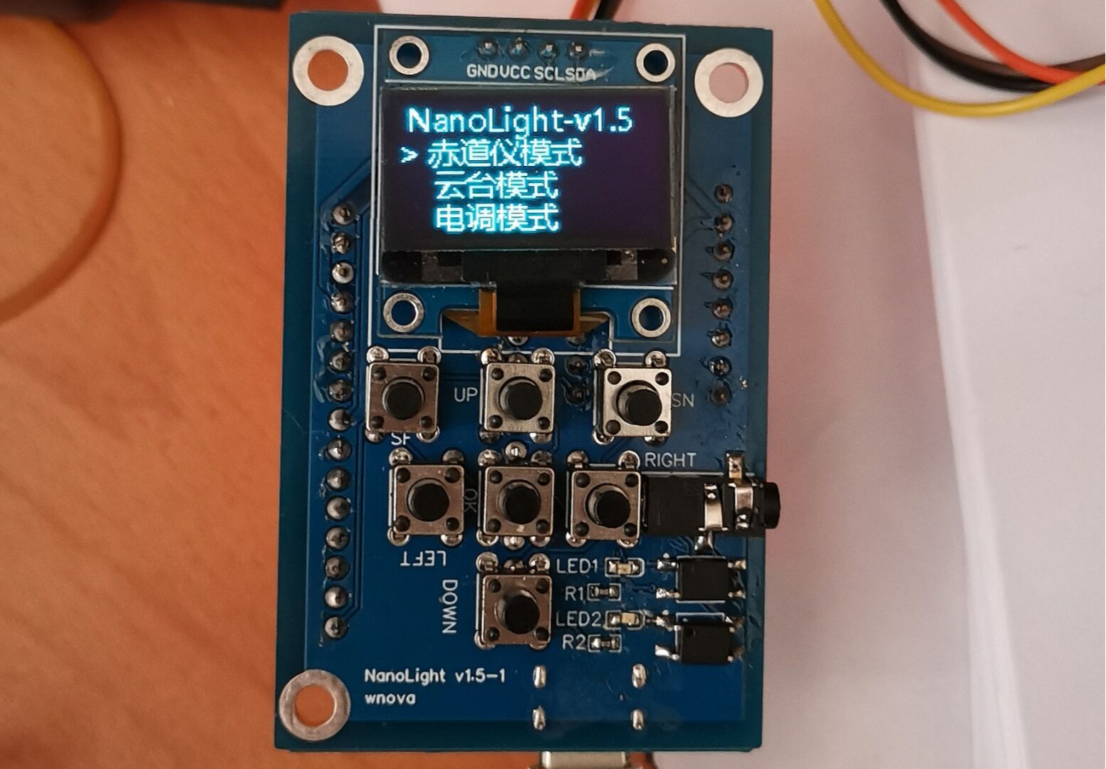

NanoLight Hoshino Equatorial Mount/Gimbal/Camera Shutter Button Motherboard
An equatorial mount/gimbal/slide control board with integrated shutter cable control.
Video link at Station B: https://www.bilibili.com/video/BV1tv4y117aC.
Features:
-Supports 5-12V stepper motors, and motor and reducer parameters can be set in the menu without programming modification -Type C port, PD protocol power supply
-Contains three modes: equatorial mount mode, time-lapse gimbal mode, and electric adjustment mode.
Materials and program firmware see project attachment
20230303 Update: If the OLED does not light up after uploading the hex firmware file, check that the hardware circuit is OK, then upload the pre-program program in the folder first, and then upload the hex firmware file.
***Soldering sequence tips***: If you do not follow this sequence, you may not be able to weld smoothly! ! !
Step 1: Solder the SMD components in the white frame. After soldering, it is strongly recommended to use a multimeter to measure whether the decoy voltage is normal before proceeding to the next step of soldering.
step2: 15p female header, use nozzle pliers to trim the pins:
step3: First frame the chip components in red (if you don’t want to solder the LED, you can directly tin it), then frame the three buttons in white:
step4: 8p female header:
step5: The remaining buttons:
step9: The remaining 20p and 8p female headersstep10
: XH2.54 4pin terminalstep11
: OLED screen
source code: https://gitee.com/wnova/nano-lightv1.5
If you like it, please give xgm a star before leavingHave
fun!
