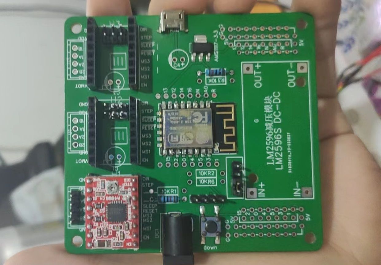

ESP8266_3-axis writing machine
Use the limited pins of esp8266 to drive 3 motors, which can be controlled by grbl. The grbl firmware modified from https://github.com/gcobos/grblesp on github.
https://github.com/DengJackNo1 The modified code of /grblesp is here. The code is based on grblesp. Modify the dev branch, add ws and telnet control, and on the basis of ws, add the index.html single file version to control grbl.
The source code of the master branch is the modified one The source code is available. After downloading, modify the wifi and compile it before use.
