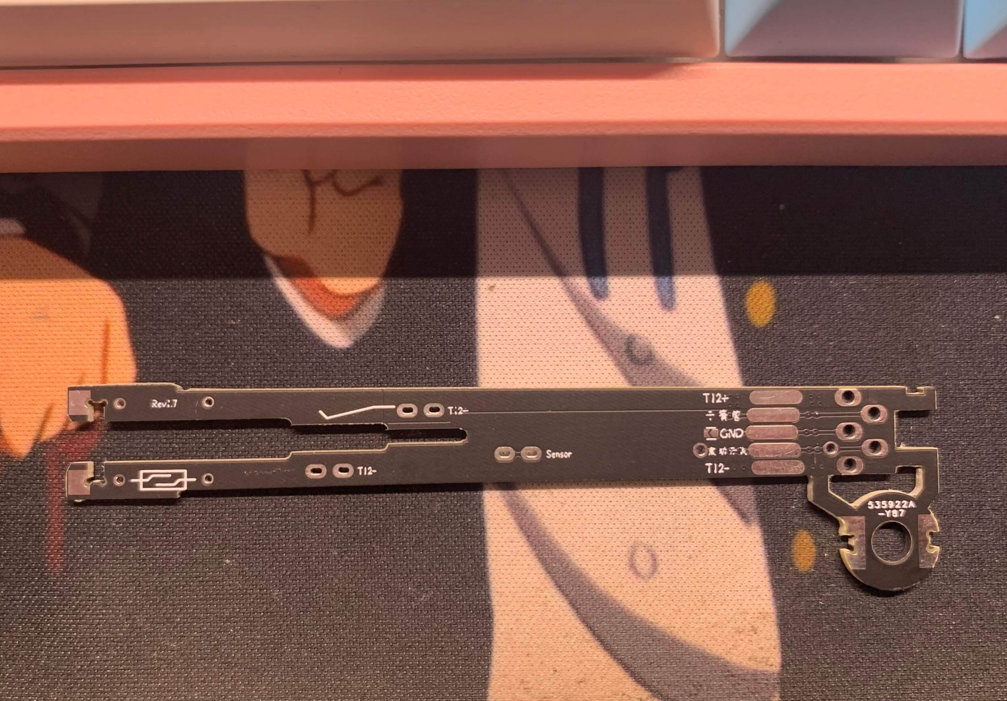

1. This project is suitable for Open T12 Zhuque T12
2. Applicable handle: "Hot-selling high-quality T12 digital display soldering station handle shell 907 modified t12 handle shell t12 bracket manufacturer direct sales" model is blue shell wire
used: "t12 soldering station 936 soldering station handle wire 907 handle high temperature resistant five-core silicone wire three-core silicone wire T12 handle model is black five-core with shielding 1 meter
3. Because GND and earth are separated, use shielded wires, and the shielded wire is pressed on GX12 Where should the female screw of -5 (as shown in the picture below) and the male screw on the main control board be connected to the ground
? 4. Actual picture:
