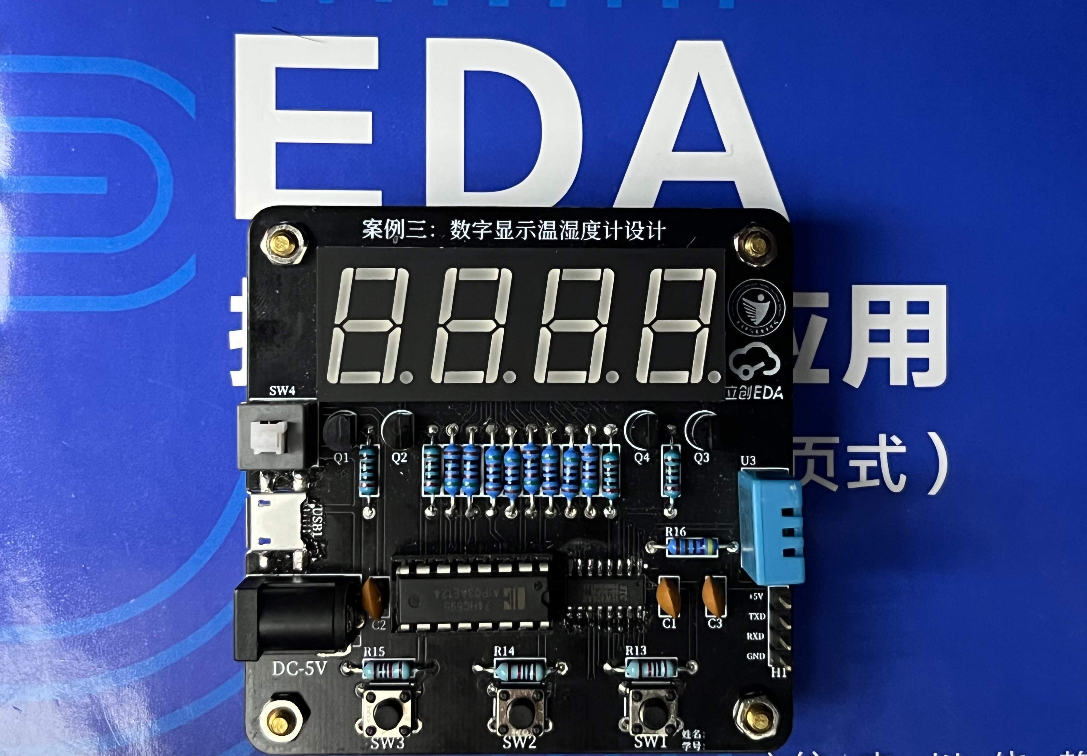

    Digital display thermometer and hygrometer is an environmental monitoring device widely used by various manufacturing enterprises today. This project is designed based on the STC15W408AS single-chip microcomputer to collect and detect the temperature and humidity of the environment.
2 Overall Scheme
    The overall scheme system block diagram is shown in Figure 2-1. The digital display thermometer and hygrometer based on the STC15W408AS single-chip microcomputer consists of a power supply circuit, an STC15W408AS single-chip microcomputer, a temperature and humidity detection circuit, a digital tube display circuit, and a button setting circuit.
3 Circuit Principle
    The power supply part adopts a 5V DC power connection socket and a Micro USB interface sink board design, and the power supply is controlled by a self-locking button.
    The DHT11 temperature and humidity sensor is used to collect the real-time temperature and humidity of the detection environment. The STC15W408AS single-chip microcomputer reads the collected temperature and humidity data, and outputs it to the digital tube through the 74HC595 shift register. The three buttons correspond to the setting, addition and subtraction functions. The user can set the upper and lower limits of the collected temperature and humidity through the buttons.
    The program download interface reserves a 1x4Pin 2.54mm spacing pin header, which can be used to burn the program using a USB-TTL tool. Use 4 M3 copper column screws to fix the board.

5 Soldering
assembly Figure 5-2 Digital display temperature and humidity meter based on STC15W408AS
