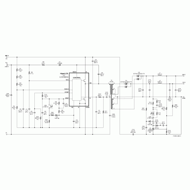

DER-282 - 100 W ultra-thin (11 mm) LLC DC-DC converter designed using HiperLCSTM LCS700HG
This document is an engineering report describing the design of a 12 V/24 V, 100 W LLC DC-DC resonant converter using the LLC control/power stage IC integrated with the LCS700HG. This power supply is suitable for LCD TVs with LED backlight. The TV circuit board requires +12 VDC and +380 VDC inputs. This document includes power supply specifications, circuit diagrams, bill of materials, transformer specification files, printed circuit board layout and performance data.
