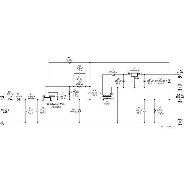

DER-508 - 4.75 W dual output power supply
DER-508 - 4.75 W Dual Output Power Supply
This document is an engineering report describing a dual output 18 V, 250 mA and 5 V, 50 mA adapter using the LinkSwitch-TN2 IC family of devices. The design demonstrates the high power density and efficiency possible due to the high level of integration, while still delivering superior performance. This document contains power supply specifications, schematics, bill of materials, transformer documentation, printed circuit layout, and performance data.
