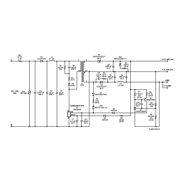

DER-744 - 8 W wide-range input, dual output, non-isolated flyback converter using LinkSwitch-XT2
DER-744 - 8 W Wide-Range Input, Dual Output, Non-Isolated Flyback Converter Using LinkSwitch-XT2
This document is an engineering report describing a non-isolated flyback converter designed to provide 5 V (650 mA) and 12 V (400 mA) over a wide input range of 85 VAC to 350 VAC Dual output. The power supply uses the LNK3696P from the LinkSwitchTM-XT2 900 V series of devices. This document contains power supply specifications, schematics, bill of materials, transformer documentation, printed circuit layout, and performance data.
