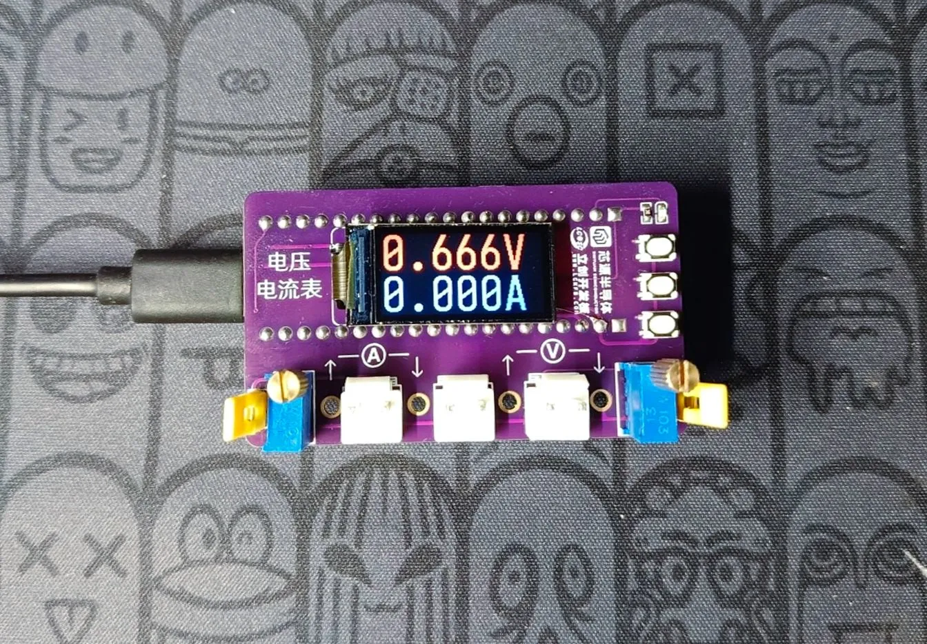

Voltage and current meters based on CW32 development board
1. Project Introduction
This project is a training project for the CW32 digital voltmeter and ammeter training camp. After fully understanding the training project, the following modifications were made:
The LDO circuit was removed, and the onboard USB power supply was used directly.
The digital tube was replaced with a TFT display screen for better display effects.
All surface-mount resistors and capacitors were replaced with 0603 packages to reduce size.
2. Hardware Design
The project requires the use of a development board, so only the external application circuit needs to be designed separately, and then connected to the development board via pin headers as an expansion board.
2.1 Power Supply Design
Since there is no DC power supply and considering the compact size of the expansion board, the external LDO circuit was removed, and the USB input of the development board was used directly as the power supply.
2.2 Voltage Sampling
: The voltage is input to the ADC of the core board using a dual-range sampling method. When using the ADC's internal 1.5V reference voltage, R5 (10kΩ) and R8 (10kΩ) can measure voltages between 0-3V through a voltage divider, while the voltage divider circuit composed of R3 (220kΩ) and R7 (10kΩ) can measure voltages between 0-34.5V.
2.3 Current Sampling: Current
sampling uses a 100mΩ sampling resistor. Based on the 3A design range, its power requirement is at least 900mW.
2.4 Analog Input:
For convenient functional testing, the voltage and current are directly controlled from the power supply through two potentiometers, connected to the sampling circuit using jumper caps.
2.5 Display Output:
The output section has been modified to output measured values ​​on a TFT display screen, which is far superior to a digital tube in both price and display effect.
3. Software Design:
The system is written in Keil 5 and uses the peripheral library provided by CW32 to control various aspects of the development board. The overall process is simple: the system clock, LEDs, buttons, screen, and voltage/current acquisition functions are initialized sequentially, and then measurements are performed and output in an infinite loop.
3.1 Clock Initialization
: An external 8MHz clock is connected to a PLL to output 64MHz via 8x multiplication to the system clock, and a tick timer is initialized.
3.2 LED and Button Initialization:
LEDs and buttons can be directly controlled via GPIO, so they are initialized together.
3.3 Screen Initialization:
In addition to initializing GPIO, the screen also requires configuration of SPI, DMA peripherals, and the screen's own registers.
3.4 ADC Initialization:
The ADC mainly uses a multi-channel sequential scan mode to measure the 0-3V voltage range, 0-30V voltage range, and 0-3A current range channels sequentially.
3.5 Voltage and Current Measurement:
A mean filtering algorithm is used for voltage and current measurements to smooth the results. Multiple ADC values ​​are sampled continuously using a circular queue, and the average value is taken. The actual value is then calculated using a voltage divider circuit.
3.5 Display Output:
For the characters to be displayed, first take the modulus, then fill in the font color and background color, and finally convert it into RGB565 data format and send it to the screen.
