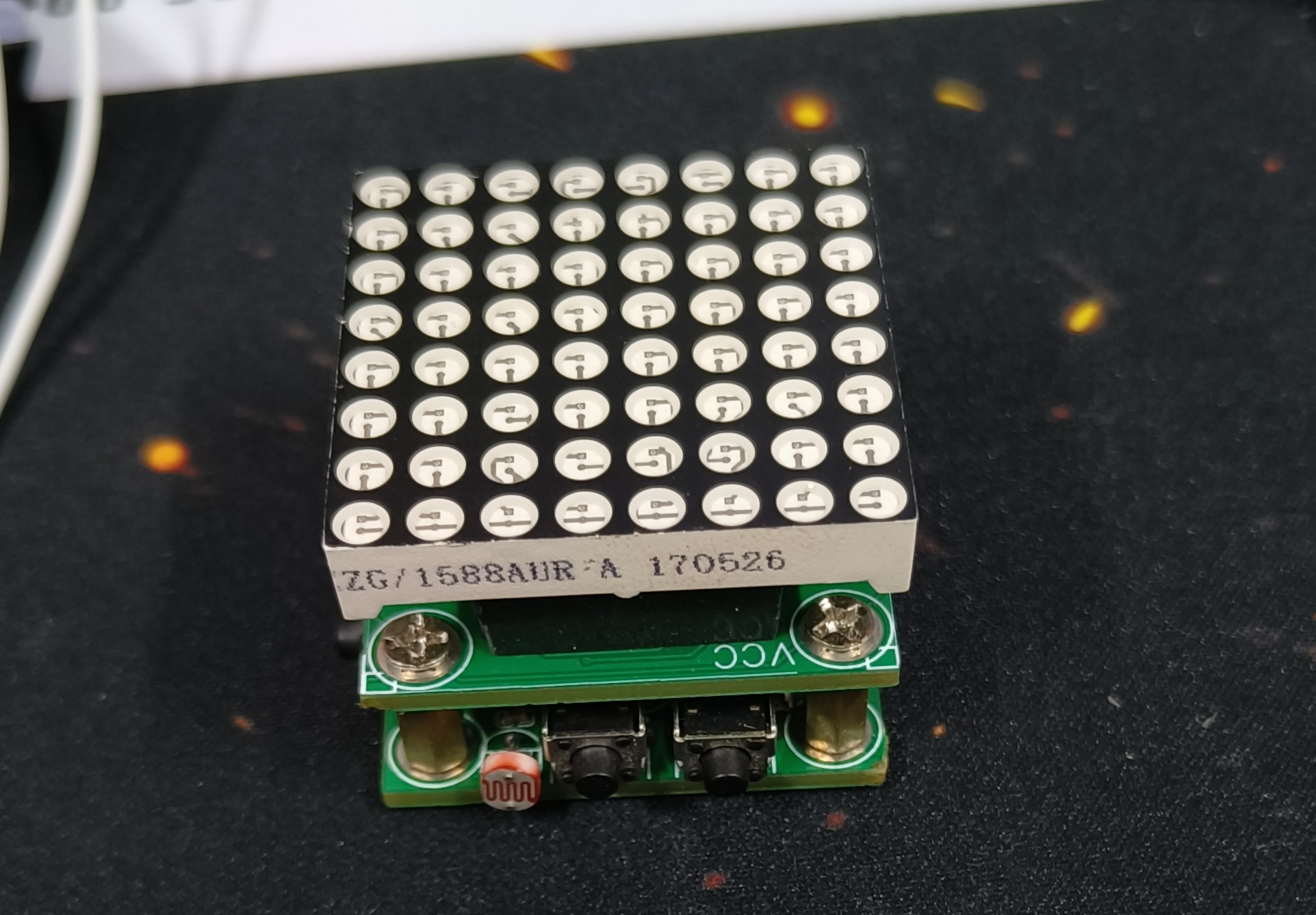

The DIY Water Reminder is a smart device based on the STC8H1K, designed to help people maintain good hydration habits. This device can remind users to drink water at set times to ensure they stay adequately hydrated, contributing to health and quality of life.
Timed Water Reminders: The DIY Water Reminder can be set to remind users at set times, such as once per hour. This helps users avoid forgetting to drink water due to being busy.
Display Screen: The device has a dot-matrix display screen that shows the current time, reminder schedule, and water level in the cup. Users can easily understand the information.
Sound Reminders: In addition to the dot-matrix display, the device is also equipped with a buzzer reminder function.
Customizable Reminders: Users can customize the reminder frequency and time according to their needs. This customization function allows the device to adapt to different people's lifestyles.
*2. Project attributes
have only been publicly disclosed on the LCSC EDA open-source platform; Original.
* 3. Open source license
GPL3.0.
Please fill in the details during the competition stage.
* 4. Hardware:
Use M3*10mm double through studs to connect the top and bottom plates. Note the soldering method between the DS1302 battery holder and the DS1302. Changing the time requires re-downloading the program. After changing the time, comment out the time-writing code and download again. Please use a passive buzzer (the sound is music - Two Tigers). If board assembly prevents board production, please delete the oval border layer in the middle of the PCB and cut it open yourself.
* 5. Software:
See the attachment for the specific source code. Open the source code in Keil and use STC-ISP to download the program to the STC8H1K chip.
