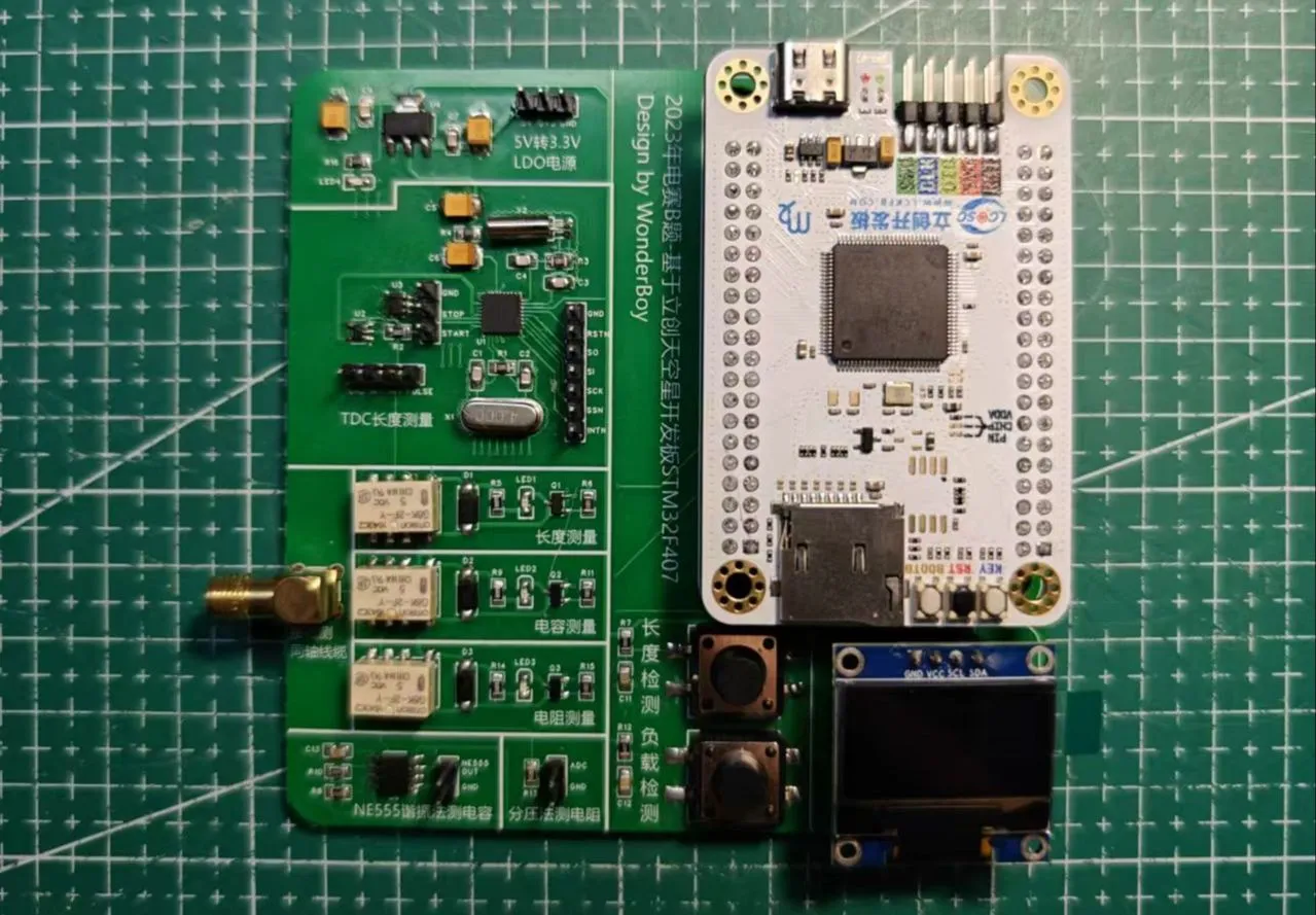

JLCPCB PCB Ordering: The PCB for this project can be ordered directly without modification. Component Ordering: Components are standardized and can be ordered directly, but a quick check is still necessary. There are two length measurement schemes for this project. The program defaults to Scheme 2, so you don't need to order the relevant components for Scheme 1. For the cable

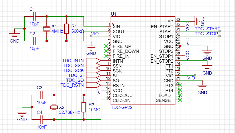

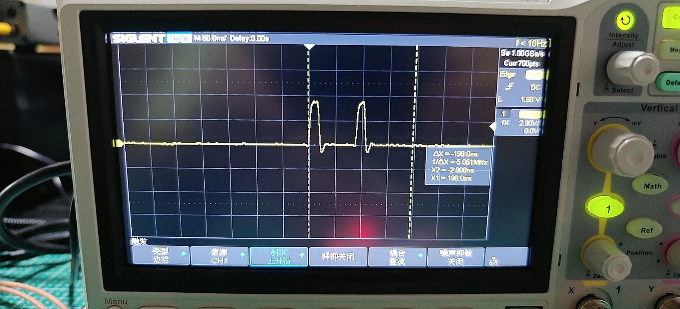

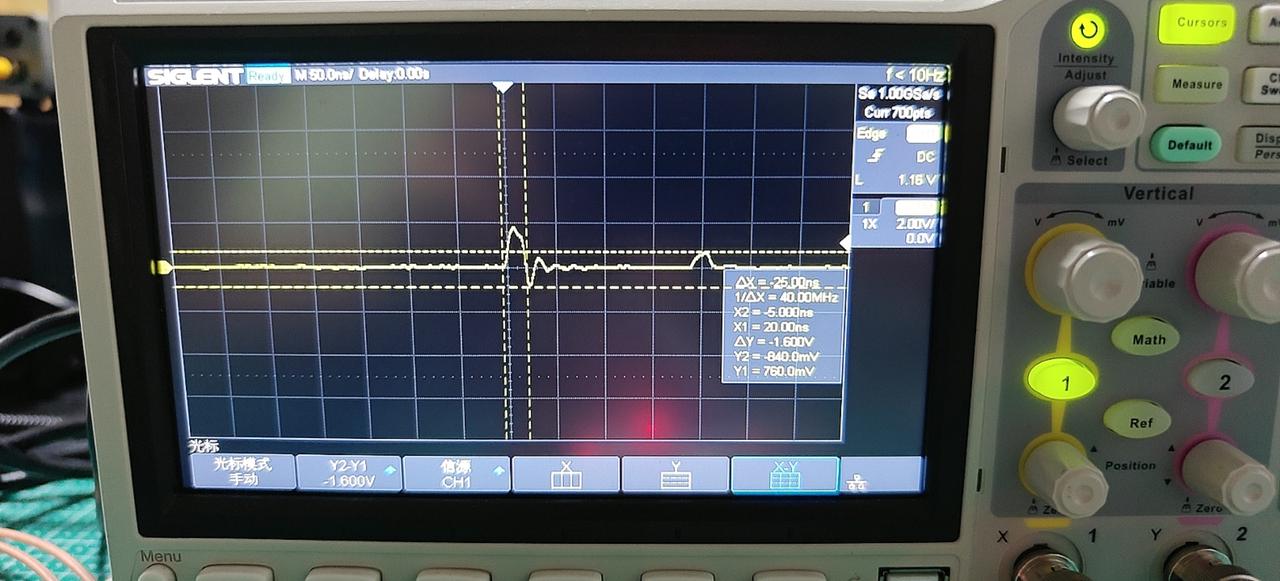

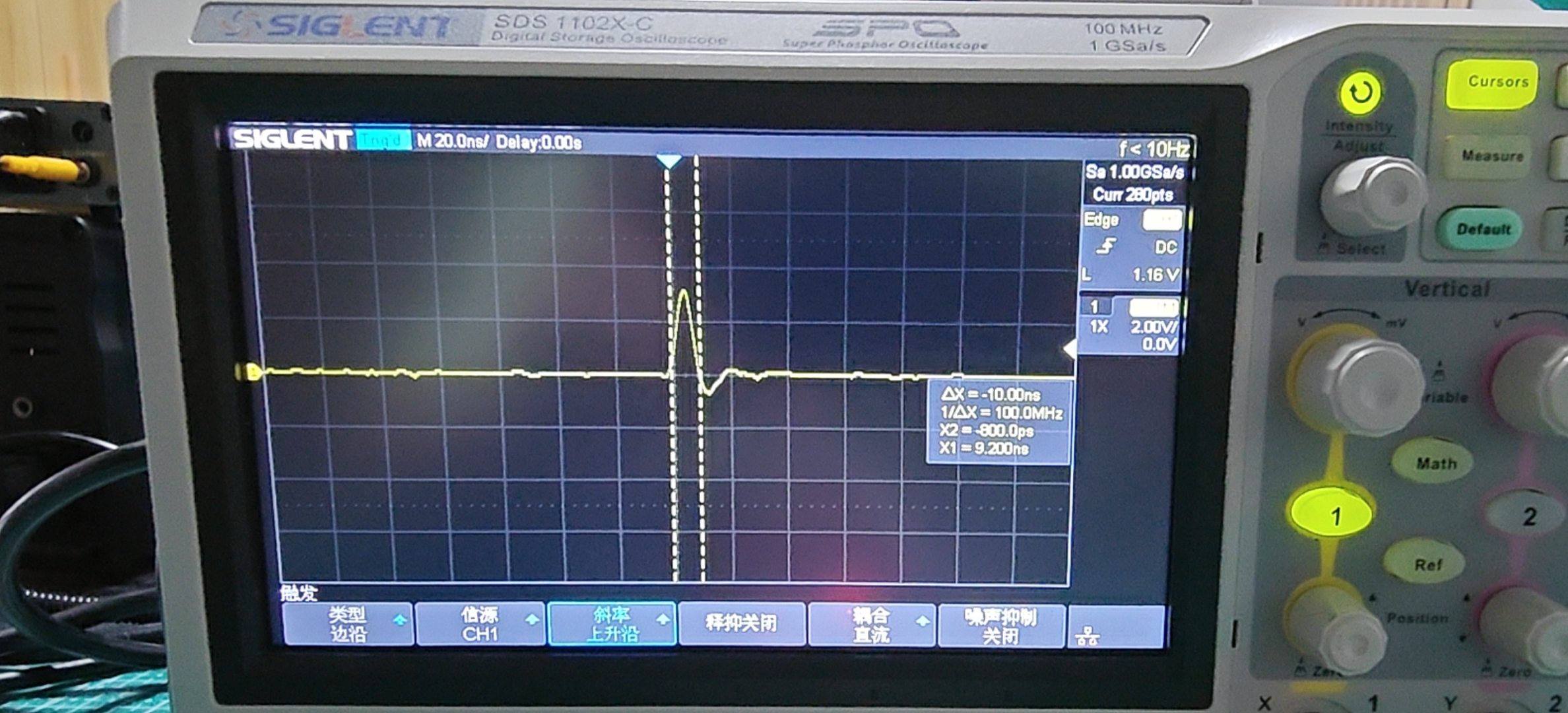

under test and load , we recommend buying RG316 coaxial cable, as the program calibration defaults to this cable. For the load, you can buy a standard calibration load, or buy an SMA connector + through-hole resistor and capacitor and solder them on yourself. PCB Soldering : There are two length measurement schemes for this project. The program defaults to Scheme 2, so you don't need to solder the relevant components for Scheme 1. Program Burning: The attached .bin/.hex files can be burned using STM32CubeProgrammer for quick replication. If you are developing this project, please refer to the attached "CLion STM32 Development Environment Setup" to set up the development environment. When testing the load, it is recommended to solder an SMA female connector onto the coaxial cable and then solder the load onto the SMA male connector for easy load replacement. III. Hardware and Software Design Introduction This problem requires measuring the length of a coaxial cable and the terminal load (resistance and capacitance), with the length measured first, followed by the load. The length, capacitance, and resistance measurement schemes are described below. Length Measurement Scheme: Two methods are available. These are switched via macro definitions in User/user.c, with Scheme 2 used by default. Length Measurement Scheme 1: TDR (Time Domain Reflectometry) Hardware Scheme The problem requires testing the length with the terminal open. If a short pulse is input from the measuring end, the pulse will be reflected at the terminal, as shown in the diagram. This scheme uses a microcontroller to toggle GPIOs to generate a short pulse. The pulse width is shown in the diagram. The microcontroller's GPIO driving capability is insufficient, specifically because the GPIO has a large internal resistance, while the cable has parasitic capacitance and resistance. Parasitic capacitance forms an RC low-pass system, causing a longer pulse rise time; parasitic resistance causes amplitude attenuation. A 74AHC1G14, a NOT gate chip, is used as the driver. According to the datasheet, the rise time is approximately 10ns when powered by 3.3V. The generated pulse, after entering the cable, will be reflected at the cable termination, but the amplitude will be halved or even smaller. For example, if a 3.3V pulse is input into the cable, the resulting reflected pulse will be less than 1.65V. Here, we use a TLV3501 high-speed comparator for pulse shaping to facilitate further processing. According to the datasheet, the TLV3501 achieves a propagation delay of 4.5ns and a rise time of 1.5ns. The following figure shows the original reflected waveform and the waveform after shaping by the TLV3501. Next, we need to measure the time difference between the reflected pulse and the excitation pulse. This requires very accurate measurement; approximately a 10ns time difference corresponds to 1 meter. Here, we use the TDC-GP22 chip to measure the time difference. The TDC-GP22 internally measures minute time differences through gate circuit delays, achieving a resolution of 45ps, thus achieving a length resolution better than 1cm. The TDC-GP22 chip uses the SPI protocol for configuration. After starting the measurement, it receives pulses from the START and STOP pins and calculates the time difference according to the user's configuration. Once the measurement is complete, it notifies the microcontroller via the INTN interrupt pin and then reads the measurement result via SPI. The chip's peripheral circuitry is shown in the diagram below, requiring both 4MHz and 32.768kHz crystal oscillators. The 4MHz crystal oscillator is used to calibrate the logic gate delay (because logic gate delay is easily affected by temperature), and the 32.768kHz crystal oscillator is used to calibrate the 4MHz crystal oscillator (the 32.768kHz crystal oscillator is more accurate than the 4MHz crystal oscillator). The program generates pulses by toggling GPIO levels. To shorten the pulse width, the program writes to registers, as shown in the code below: `PULSE_GPIO_Port->BSRR = (uint32_t)PULSE_Pin` ` PULSE_GPIO_Port->BSRR = PULSE_Pin; // Set, 1` The TDC-GP22 driver configures the TDC-GP22 by writing to registers via the SPI protocol. The registers of this chip are quite complex; specific functions should be checked in the datasheet. Here, we briefly list the register configurations and functions for this project. A detailed configuration can also be found in the attached Excel spreadsheet. Register address values ​​and their functions : 0x80 0x009620 Measurement range 1, 4M crystal oscillator frequency divider, 4M crystal oscillator oscillates continuously after power-on, automatic calibration, calibration time is 8 32K cycles, START and STOP rising edge sensitive. 0x81 0x014100 Time difference calculation method: first pulse of STOP1 minus first pulse of START. 0x82 0xE00000 Enable all interrupt sources, START and STOP single edge sensitive. 0x83 0x180000 Almost all default values . 0x84 0x200000 All default values. 0x85 0x080000 Noise unit disabled. 0x86 0x010000 Measurement resolution doubled from 90ps to 45ps. TDC-GP22 connection pins to microcontroller are as follows: Microcontroller pins TDC-GP22 pin functions : PB15 MISO SPI master transmit, slave receive. PB14 MISO SPI master receive, slave transmit. PB13 SCK SPI clock PB12 SSN SPI slave select, active low PB11 INTN TDC interrupt signal issued, active low

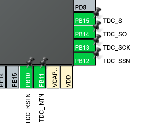

The PB10
RSTN
TDC reset is active low.
The program uses software SPI to configure the TDC-GP22. See User/Drivers/tdc.h and User/Drivers/tdc.c for details.
The TDC_Config() function is responsible for configuring the registers. Modify this function if you want to implement other measurement functions.
If you have modified the pin configuration or migrated the microcontroller platform, please modify the macro definitions and functions at the beginning of the User/Drivers/tdc.c file. The relevant business logic
for
length measurement is in User/getL.h and User/getL.c, including calibration parameters, unit conversion, and averaging of multiple measurements.

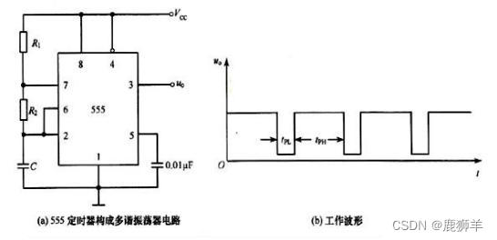

Length measurement scheme two: NE555 capacitance measurement
method hardware scheme
The parasitic capacitance of coaxial cables is relatively stable with length. According to the datasheet, the parasitic capacitance of the RG316 coaxial cable is 96.45pF/m.
Therefore, the length of the coaxial cable can be indirectly measured by measuring the capacitance. The NE555 oscillating circuit is a good capacitance measurement scheme.
The following diagram shows a typical NE555 square wave generator circuit:
the frequency of the square wave it generates is related to the values ​​of the resistors and capacitors, as shown in the formula below.
If we fix resistors R1 and R2 and replace capacitor C with the capacitor to be measured, we can indirectly measure the capacitance through frequency. This method can achieve a measurement accuracy better than 1pF.

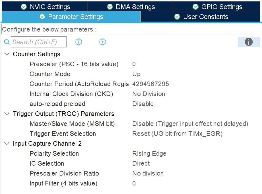

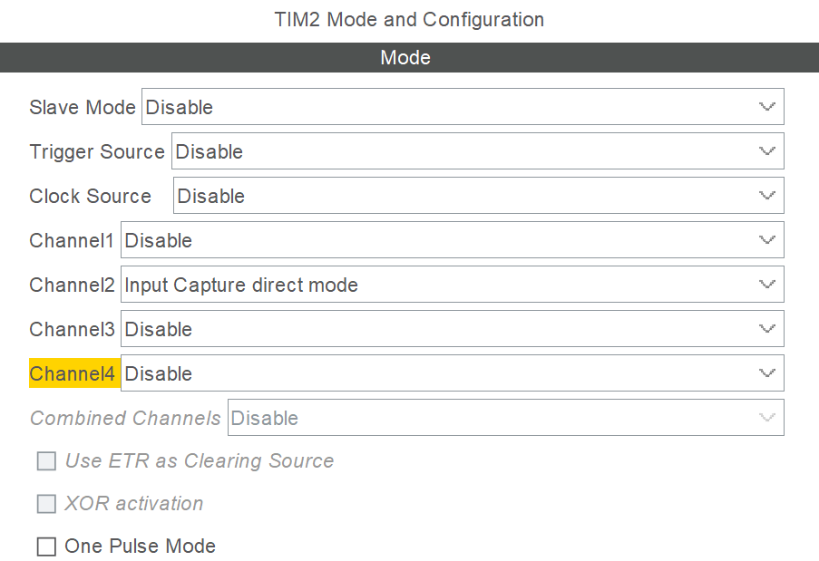

The program implements
the microcontroller to capture and measure the external square wave signal using a timer input. Here, TIM2 is chosen because its counter is 32-bit, which is convenient for processing.
Interrupts are enabled, and the GPIO pull-down resistors are turned on.
Each time the rising edge of the external signal arrives, the interrupt callback function is entered. In the callback function, the timer count value CNT is read, and the frequency of the external signal can be obtained. The relevant code is in User/getC.h and User/getC.c, and the relevant calibration parameters are also contained therein.

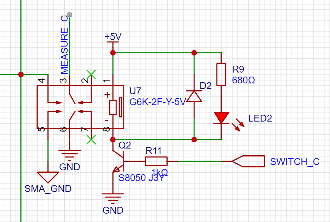

uses signal relay switching: length measurement, capacitance measurement, resistance measurement
