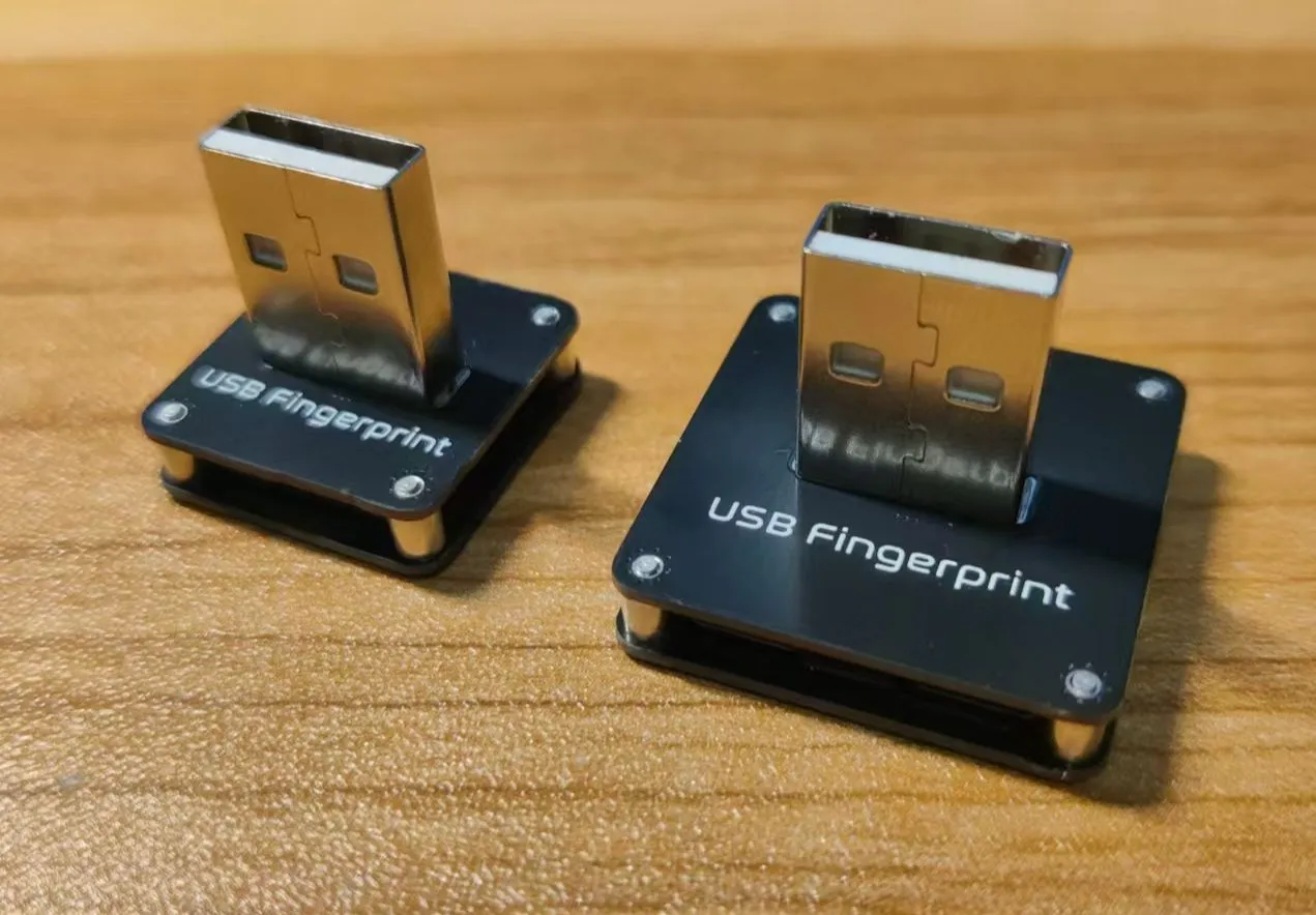

USB fingerprint unlocker
USB Windows Hello Fingerprint Unlocker
Precautions
: Surface Mount Screw Types: M1.4x3.5x3 (compatible with both large and small fingerprint modules) M1.4x2.5x3 (compatible only with small fingerprint modules) http://e.tb.cn/h.gFORRMfQvepkzQJ?tk=o3pY3PS569c
Screw Types: Black M1.4x3x2.5
USB Straight-in Male Connector (select white color) http://e.tb.cn/h.gFWbdQ4tPswioQ7?tk=guqj3PSVJeb
Supports the two fingerprint modules shown below. Purchase channels can be found in the following two items. Always check the wiring sequence before powering on!
https://oshwhub.com/pomin/integrated-desktop-tool-windowsh
https://oshwhub.com/willew/ji-cheng-windows-hello-zhi-wen-dial-hub-de-zhuo-mian-gong-ju (
Assembly)
PDF_USB Fingerprint Unlocker.zip
Altium_USB Fingerprint Unlocker.zip
PADS_USB Fingerprint Unlocker.zip
BOM_USB Fingerprint Unlocker.xlsx
