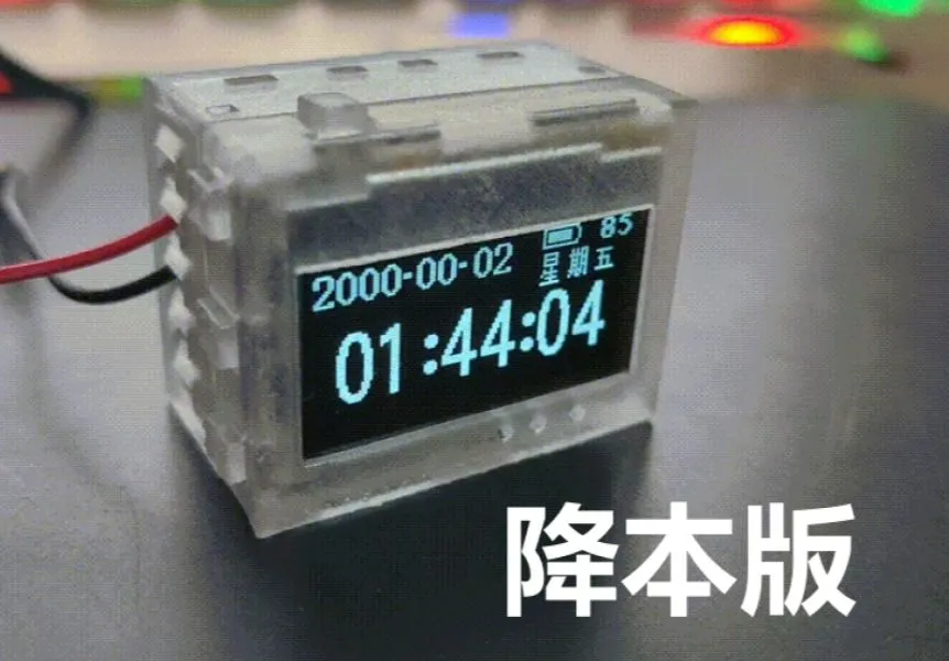

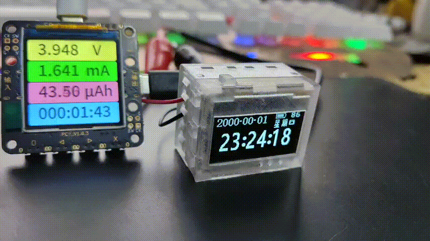

[Always On for 24 Days] Low Power Consumption - Mini Desktop Clock (Downgraded Version)
The flickering and ghosting issues are due to compression of videos and photos; they won't appear in real-world viewing. For
actual effects, please refer to the initial GIF (below) or video

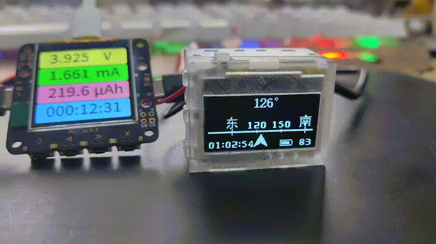

Project demonstration video
    : Reduced version feature demonstration and power consumption demonstration: https://www.bilibili.com/video/BV1hZ421g7mz

     This project is based on [24-day constant light]. Low-Power Mini Desktop Clock (https://oshwhub.com/yq-qvq/low-power-consumption-for-24-days-desktop-clock) This project represents a significant cost-reduction improvement to the previous model. The current batch cost is approximately ¥50+, but the cost per unit will increase due to the inability to share shipping costs.
     This project is a low-power desktop clock based on the legendary 32-bit 51 microcontroller STC32G12K128 chip as the main controller, operating at 5V... At 255 brightness in TV mode (factory default setting), the average power consumption is 1.7378mA (6.8593mW), and it can run for about 24 days. It is equipped with RTC, temperature and humidity, magnetic intensity, acceleration, air pressure and light intensity sensors for development.
Note that
     this project is powered by a soft-pack lithium battery. Please pay attention to safety when using it. Do not leave it unattended while charging to avoid physical damage to the battery. Avoid overcharging, over-discharging and short circuits. Avoid placing it in harsh environments such as high temperature or low temperature.

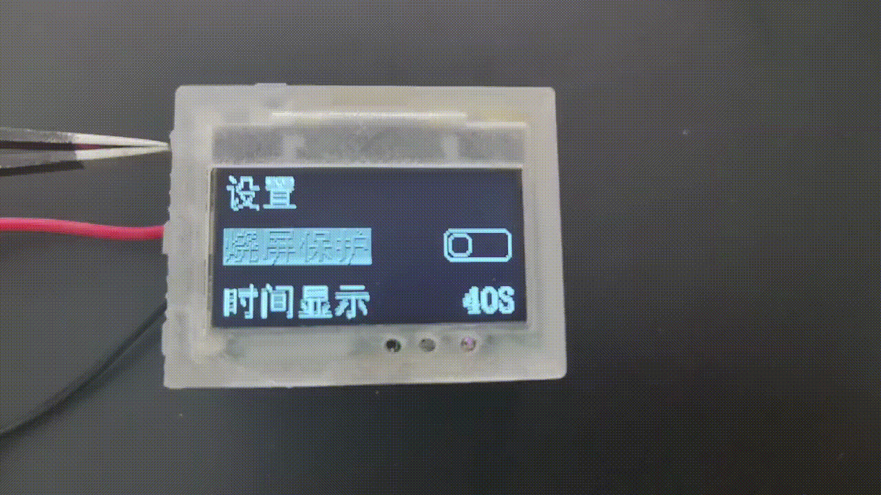

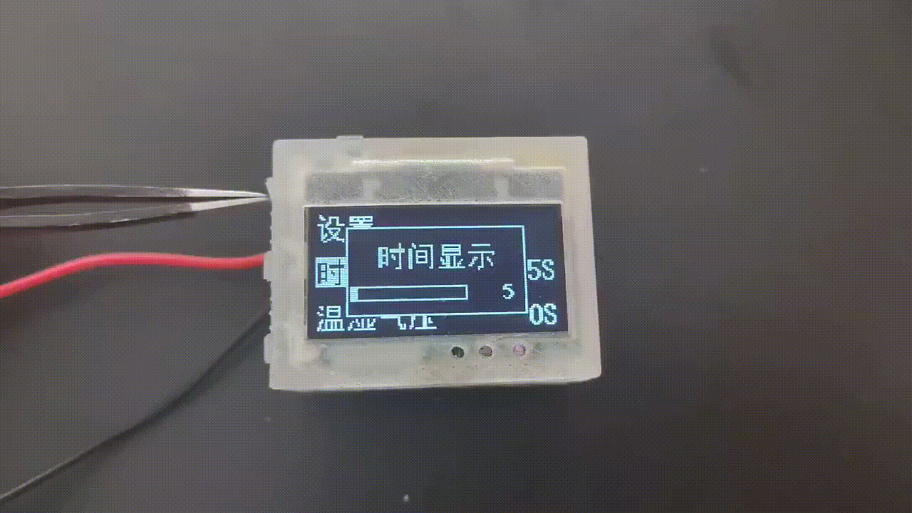

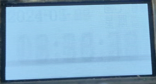

Screen burn-in issue:
     This project uses an OLED screen. If a certain pixel is lit for a long time, light decay will occur, resulting in a "mark" on the screen. The image below shows the screen burn-in situation after 6-7 months of use. The horizontal line is the camera shooting problem. You can see that the mark is left in the frequently displayed area, but it is almost invisible when displaying the time interface, unless you enter the menu or a pure white screen.
     Therefore, the screen is essentially a consumable item and can be replaced every year or year and a half. If you mind this, please do not copy or purchase.

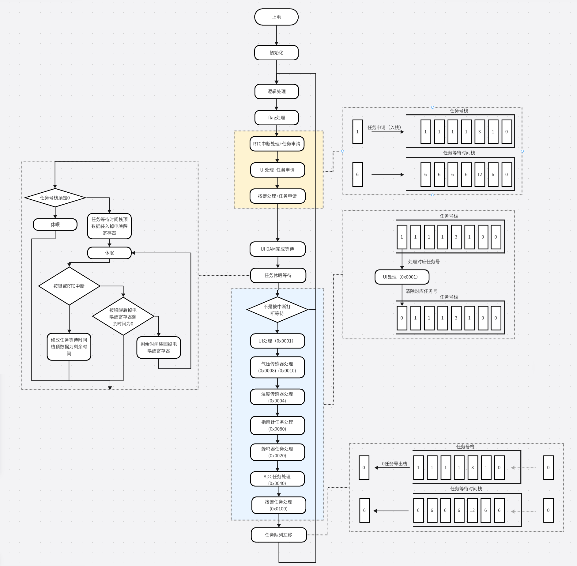

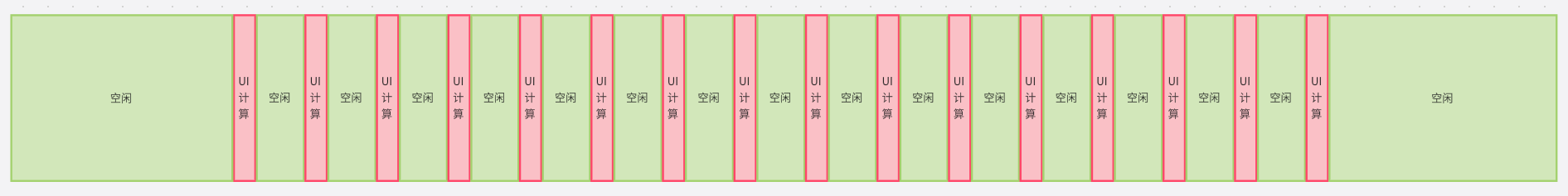

        To address this issue, similar to how a worker can set an alarm clock, a power-down wake-up timer can be used. By setting the time of the power-down wake-up timer, the MCU can be controlled to wake up at the specified time after going into sleep mode. Then, we can take it a step further, for example, to shift 32 pixels, we would set 31
        alarms. To do this, I introduced two arrays: a "sleep time array" and a "task number array" (each bit represents a task). The values ​​of the two arrays correspond one-to-one. For example, to perform a 32-pixel shift, which needs to be performed 32 times, I first reserve 32 tasks in the "sleep time array" and the "task number array", as shown in the figure below.
        Each time, the MCU checks the values ​​in the "sleep time array" [0] and the "task number array" [0]. If they are not equal to 0, the value of the "sleep time array" [0] is loaded into the power-down wake-up register, and the MCU goes into sleep mode. After waking up, the corresponding task is matched according to the value of the "task number array" [0]. After the task is completed, the value of the entire array shifts one position to the left. When the values ​​in the "sleep time array" [0] and "task number array" [0] are both 0, it indicates that the UI refresh task has been completed, the power-off wake-up register is closed, and the system has completely entered sleep mode, waiting for the external button to interrupt the task and wake it up.
        However, there is not only one OLED screen refresh task in the project. For the sensor measurement waiting task, in order to ensure the timeliness as much as possible, it is impossible to measure it after the UI refresh is completed. Of course, we hope to do both at the same time. At this time, we need to write an insertion algorithm to insert the task into the task queue. For example, to insert a barometric pressure measurement task into the queue ("task number array" bit1 = 1), it is necessary to wait 15ms (6+6+3) and insert it into the queue in the figure above, as shown in the figure below. It can be seen that when the values ​​cannot overlap, it is necessary to interrupt the queue to insert the value. 3 means that both bit0 and bit1 are 1.
         For example, on the basis of the above, to insert another barometric pressure measurement task into the queue, it is necessary to wait 12ms and insert it into the queue in the figure above, as shown in the figure below. It can be seen that when the values ​​overlap, it is not necessary to interrupt the queue to insert the value. It is only necessary to add the bit corresponding to the task number.
     As described above, we know that when a microcontroller refreshes UI animations, it doesn't refresh continuously. There's always a certain interval between each pixel movement; otherwise, the movement would be too fast. For example, in the main menu mode, three 32x32 icons are displayed. The screen length is 128 pixels, and the icons are spaced 16 pixels apart. Therefore, to complete one scroll, it needs to translate 48 pixels, or 48 times. Assuming a 6ms wait between each movement, one translation takes 282ms (not including other execution time). If the microcontroller isn't doing anything else during this 282ms time, it's essentially idling. We can reduce power consumption by replacing this idling time with a sleep mode. This requires pushing the 48 UI refresh tasks (task number 0x0001) and the 6ms interval onto the task number stack and the task wait time stack, which are then processed by the task sleep waiting module. The microcontroller will then wake up from sleep 48 times at 6ms intervals, executing one UI refresh task each time.

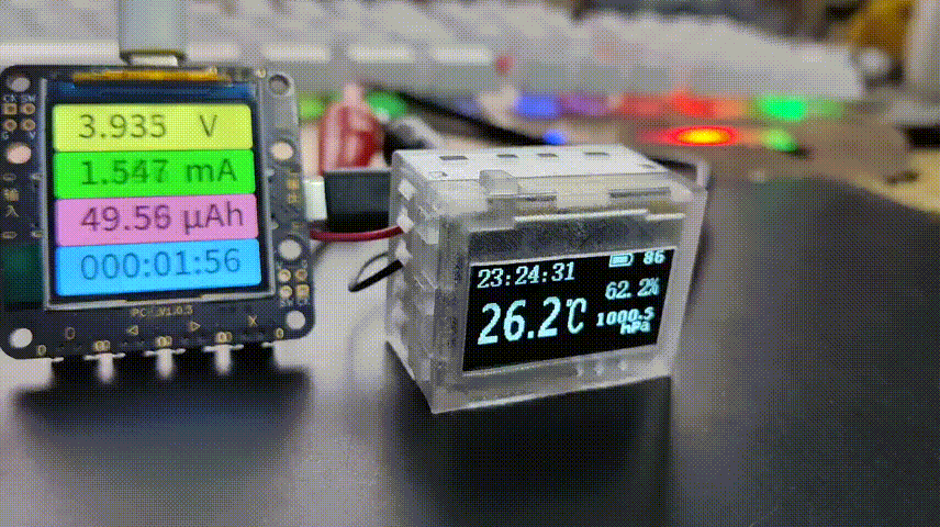

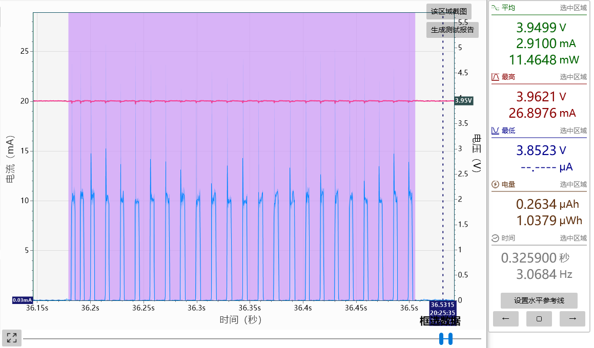

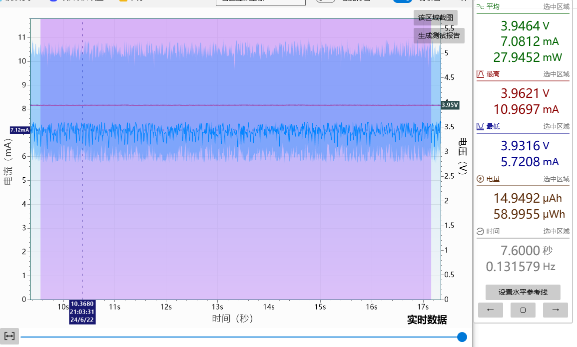

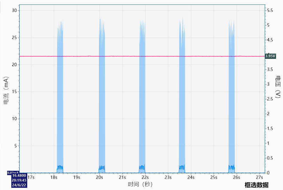

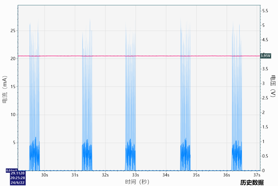

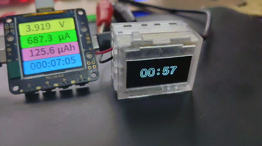

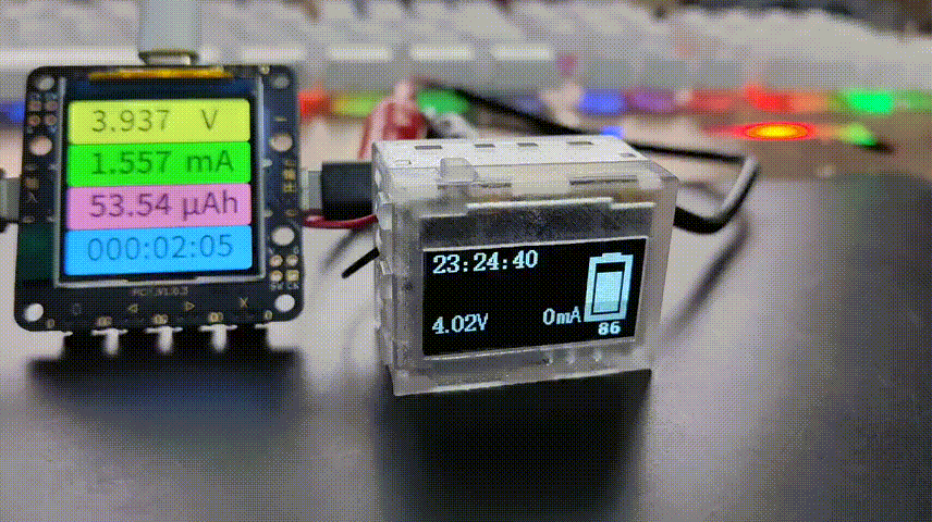

     The following images are data collected from the test PCB. The test environment is a power board + test motherboard (only the FFC socket, MCU, and buttons are soldered). The test access points are the two ends of the battery output.
     Since the MCU is powered by a step-down 2.7V supply, the actual 2.7V current should be converted by multiplying by 1.4. Of course, the battery is the final power source, so using the original data is also fine.
     The while(1) test simulates the full operation of the microcontroller. The current can be seen to be around 7mA.
     The main menu scrolling test moves the main menu UI once every 1-2 seconds. The average current is around 1mA. Zooming in, we can see that the current has 48 intervald spikes, indicating that the microcontroller works intermittently. The test involved 48 pixel movements, followed by a hibernation
     test of the secondary menu scrolling. The main menu UI was moved every 1-2 seconds. The average current was around 2.9mA. Zooming in, 24 spaced current spikes were observed, indicating the microcontroller intermittently worked 24 times, completing 24 pixel movements before returning to hibernation. Because more calculations were required than for the main menu movement, the current spikes had larger pulse widths, resulting in higher power consumption.
     The previous code contained a serious bug in the framework: the queue-jumping algorithm. While a queue was being interrupted, the waiting submodules for the task to hibernate did not accept this, blocking the current task until it finished. This caused noticeable system congestion when waiting for tasks with long waiting times. For example, after enabling light control, ambient light data was acquired every second, with readings taken 200ms after each measurement. If the user was on the menu interface and waiting for sensor data, pressing a button would require waiting for the scheduled time to complete before UI scrolling could begin. Macroscopically, this manifested as intermittent stuttering after pressing the button. The correct behavior should be that when the button is pressed, if the submodule waiting for the task to sleep is currently sleeping for other tasks, it needs to be stopped, the remaining time is read back and filled into the top of the task waiting time stack, and then the task is inserted into the queue according to the source of the interrupt. After discovering this bug, no matter how I fixed it, it wouldn't work. Then, on the morning of June 24th, 2024, I made a random change and it actually fixed! Currently, no abnormalities have been found in testing.

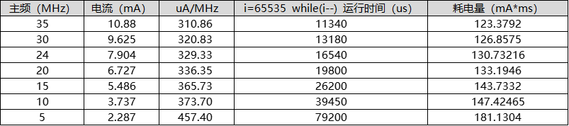

     The MCU used in this design is the legendary 32-bit 51 STC32G12K128. Since I don't know how to use other series of microcontrollers, I had to choose this model. The maximum clock frequency is 35MHz, and the maximum stable clock frequency for this project is 30MHz. Exceeding this will cause random and inexplicable restarts. This problem bothered me for two weeks.
     Power consumption is approximately 310uA/MHz, and the actual measured power consumption in sleep mode is around 2uA. The edge triggering of the IO port interrupt in power-down mode has a hardware problem; triggering one may trigger another, making it difficult to maintain.

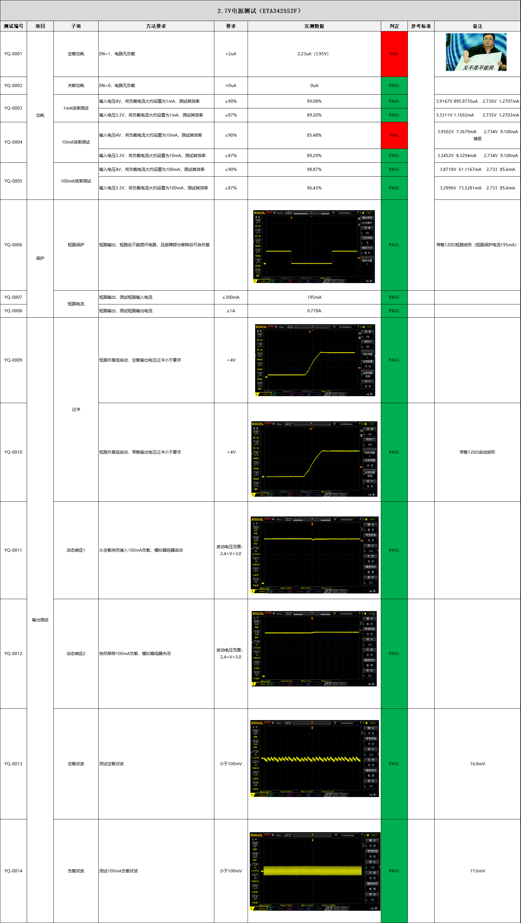

     for the MCU, sensors, buzzer, and OLED logic is provided by an ETA3425. The power supply is provided by a DC-DC synchronous rectification buck converter, with the supply voltage set to 2.7V. This voltage is limited because it also needs to charge the RTC battery, so it cannot be reduced too much.

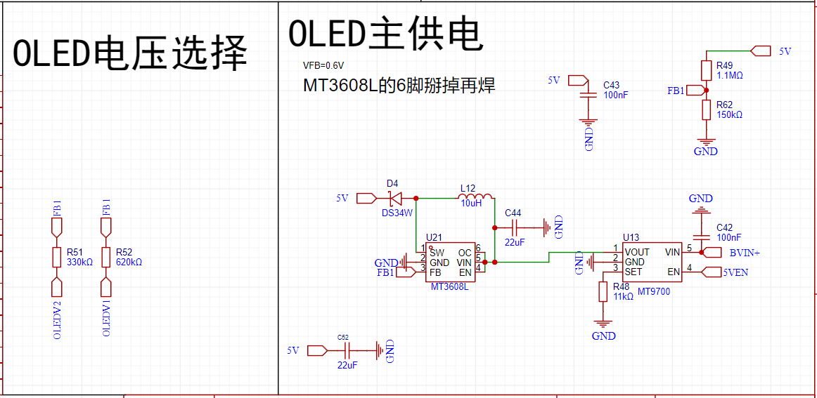

  The OLED display's
     built-in charge pump efficiency is extremely poor, so a DC-DC boost converter is recommended. Synchronous rectification boost is not recommended because its efficiency rarely exceeds 80%.
     The OLED display power supply is provided by the MT3608L DC-DC asynchronous rectification boost converter, with selectable supply voltages of 5V, 6V, 7V, and 8V. The MCU controls the switching of the OLEDV1 (open-drain) and OLEDV2 (open-drain) pins.
     The MT9700 is a current-limiting chip to prevent output short circuits.
     OLEDV1 1 OLEDV2 1 5V
     OLEDV1 0 OLEDV2
     1 6V OLEDV1 1 OLEDV2 0 7V
     OLEDV1 0 OLEDV2 0 8V
     OLEDV1 (quasi-bidirectional) 1 OLEDV2 (quasi-bidirectional) 1 13V+ It was originally designed to have an isolated MOSFET, but this was later removed to reduce costs.
The MT3608L (72mV ripple) has a 10uf
output voltage (V).
Output Current (mA)
Output Power (mW)
Input Voltage (V)
Input Current (mA)
Input Power (mW)
Efficiency
5.018
1.521
7.630
3.873
2.230
8.637
88.35%
4.986
3.030
15.108
3.873
4.360
16.886
89.47%
5.037
156.250
787.031
3.740
247.000
923.780
85.20%

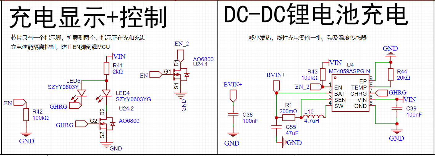

  Lithium Battery Charging
     Lithium battery charging is handled by ME4059ASPG-N, using DC-DC synchronous rectification and step-down charging. The charging current is approximately 550mA, which can significantly reduce the temperature rise caused by linear charging. Reserved control pins EN_2 and GHRG.
     EN_2 is the enable pin of the ME4059ASPG-N. It can be briefly disabled to obtain the actual battery voltage when measuring battery power during charging.
     GHRG is the charging status indicator port, used to determine battery status and whether the battery is active.

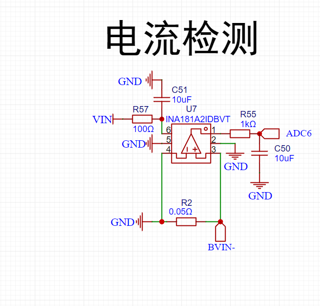

  Lithium battery charging current detection
     uses the INA181A2IDBVT chip to provide 50x differential amplification. The sampling resistor is placed on the low side to prevent leakage (placing it on the high side would result in approximately 11uA of leakage current).

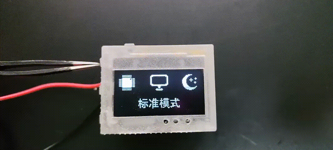

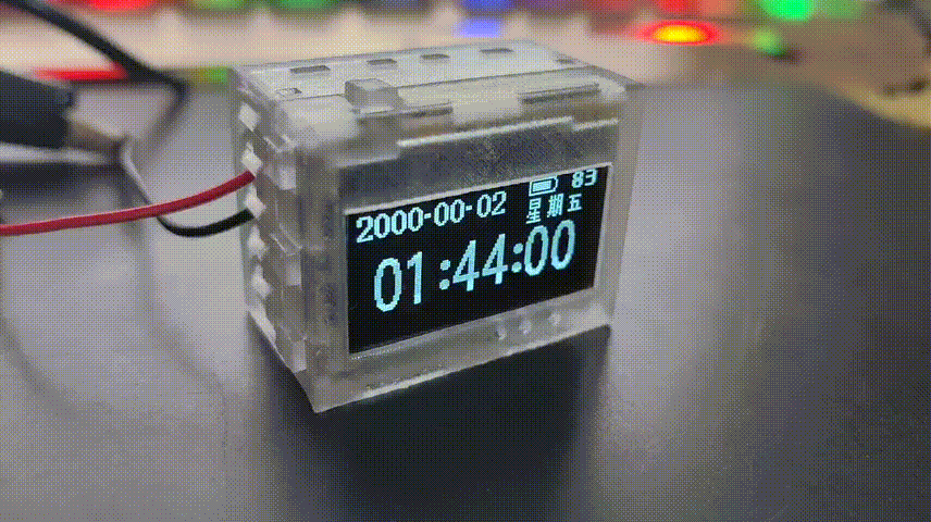

Current features include
standard mode,
burn-in protection,
time display,
temperature, humidity, air pressure, and
power status.
Hourly chime , sleep mode
setting, time display, temperature, humidity, air pressure, power status, hourly chime, deep sleep, sleep screen display settings, environmental information ( temperature, humidity , air pressure , light intensity, brightness ) , screen brightness settings, voltage level automatic adjustment, UI dynamic , UI static, extremely dark mode , TV static linkage, voltage brightness magnification , compass, level, time settings ( seconds , minutes , hours, Sunday , month, year ) , alarm clock settings (10 alarms) , seconds, minutes, hours, Sunday , Saturday, Sunday, Sunday, Sunday, alarm clock duration switch, incremental alarm clock, stopwatch, sound settings (button sounds, sound length, master switch, tone adjustment, volume adjustment ) , flashlight , power management (external power supply, internal power supply , power supply voltage  , charging current, remaining battery life protection (currently unavailable), system settings ( save parameters ) , anti-accidental touch (currently unavailable), 12-hour clock (currently unavailable ), screen flip (currently unavailable ), sleep schedule (currently unavailable), start sleep ( currently unavailable), end sleep (currently unavailable), system information (main controller model, thermometer, hygrometer , barometer, light intensity meter, accelerometer, magnetometer , clock chip, screen, main controller, number of buttons, version number, machine model , author, factory mode , sensor, temperature compensation , humidity compensation, air pressure compensation,  ADC adjustment )
